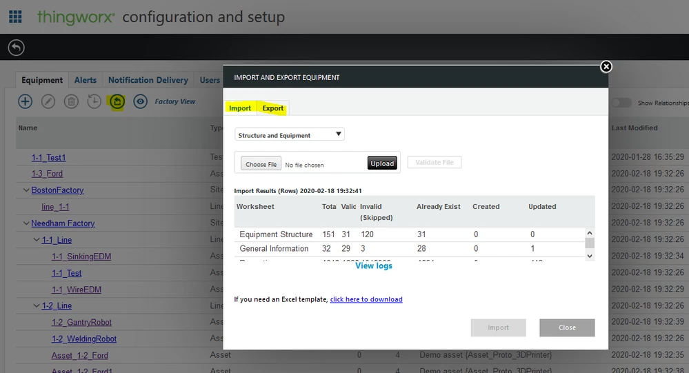

Feb 18, 2020 8:07 PM UTC
Hi @Sri1
Could you please elaborate your statement ,  what you have build on the the top of manufacturing app by adding extra tails and have also done some configuring changes? Accordingly we can suggest you right way for  export/ import for your  development work.
If you have added assets and properties you take that in excel export and import it back in different instance. As shown below.Capture.PNG
Additionally, you can  export/import configuration and data from hamburger Menu, as shown below.
