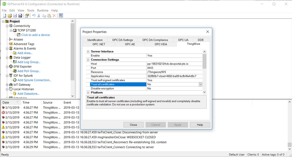

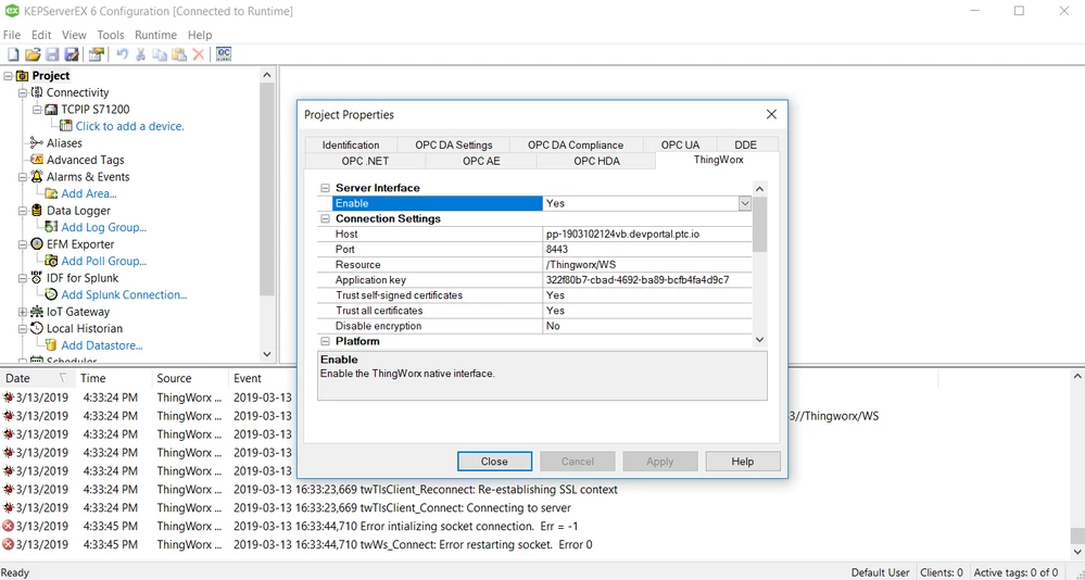

I tried many times I don't know what is the problem , please I need help !!1.PNG2.PNG

Hi @AhmedSaafan ,
It seems there is an configuration issue at your Kepware side. Can you validate issue by setting  connection settings values as below:
  • Trust self-signed certificatesYes
  • Trust all certificates = No
  • Disable encryption = No

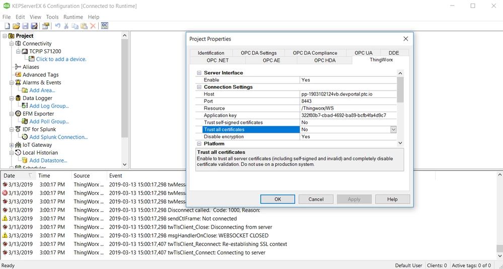

March 13, 2019
