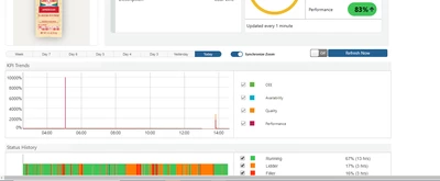

When my shifts change I get a big spike in my OEE. I was wondering what I can put in to stop this from happening. See pics below.
Also, looking for a way to clear OEE calculations and start new when I have a data change on a SKU number. I do not want to erase data out of the database just start fresh and clear counts and time info stuff. I cannot find the service that could do this for me.
Shift is at 5 am and 1pm as you can see the jump in the data thus throwing off my graphs.

Looking for ways to stop the Spike when the shift changes. Performance Spikes so Not sure where to clip KPI calculate unless there is a Produced count. During Shift change if there is no change in machine and the outfeed counts before infeed this will make a huge spike in Performance especially if the outfeed count is *6 or something.
