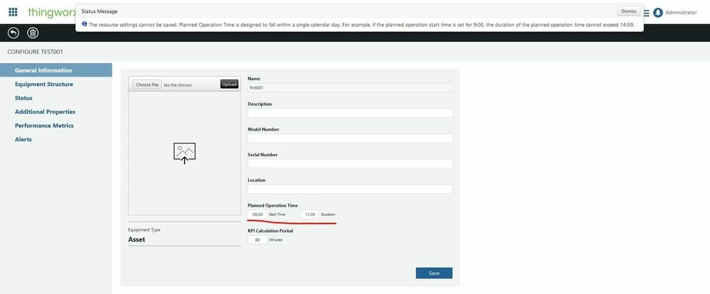

I need to change plan time to "08:00 - 17:00".
But, It's error like below picture.
How to change it???
And I need to make multi shift plan time. How to do that?

Hey @ssriuaipornchai
the second field is the duration and not the end time of the shift. So in your case you have to enter 08:00 for start time and 09:00 for the duration (9 hours from 08:00 am to 05:00 pm).
Multi shift is not available out of the box but can be implemented by customizing the KPI calculation.

@ssriuaipornchai ,
Sorry i have to correct my self after talking to our product management team.
You have to write your own service in Thingworx Composer that calculates the KPI´s based on your shift mode. The current version does not support adjustments in the existing calculations.
We are currently working on a flexible and configurable KPI calculation that also supports multi shift models. This is planed for the next major release in June.
