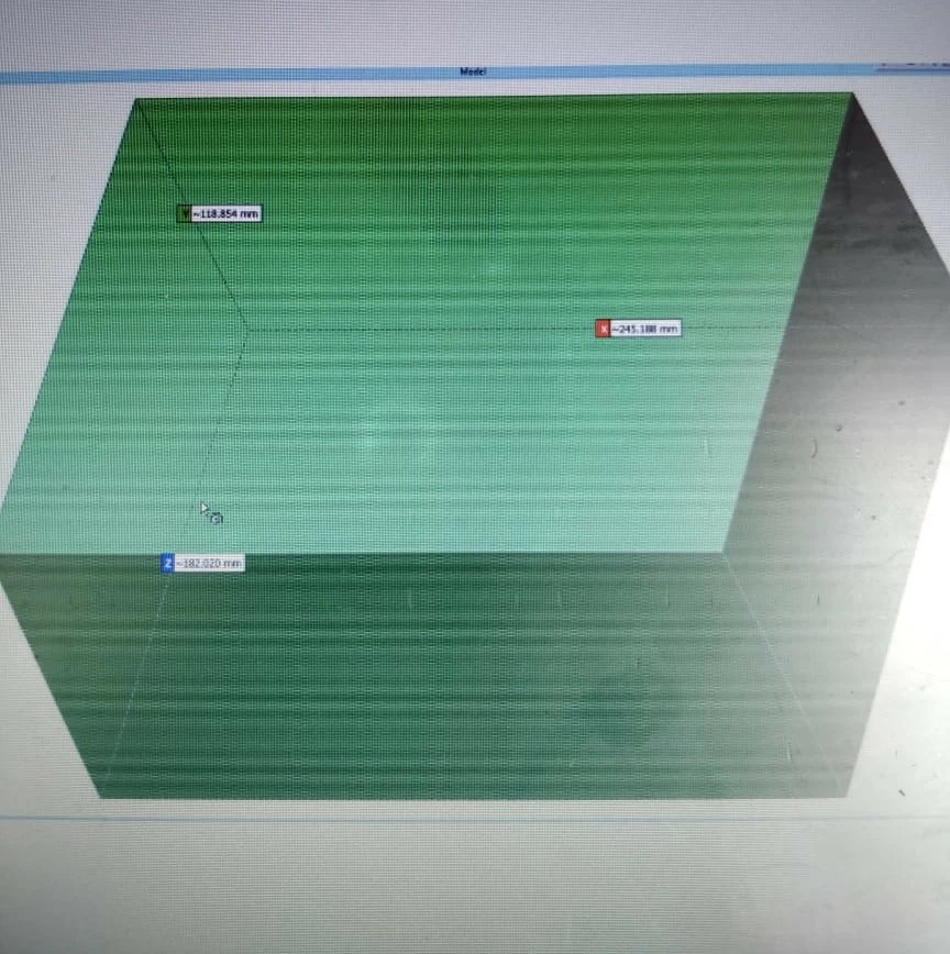

How to display bounding box in thingworx mashup ?
In Creo, a bounding box shows minimal box size in which you could put your components, models, or assemblies.
The box shows the limit in the X, Y, and Z-axis.
we can see the bounding box in creo view. Please check the attached screenshot of the bounding box with X, Y and Z-axis in creo view.
Is there any way to see these bounding boxes in thingworx mashup?
i have checked thingview widget but could not find any properties in thingview widget where we can set the values of boxes.

Displaying a bounding box along with its coordinates (x-axis, y-axis, z-axis) isn't feasible with the current version of ThingView widget.
However, there is a widget property "Gnomon" which would highlight the axis
