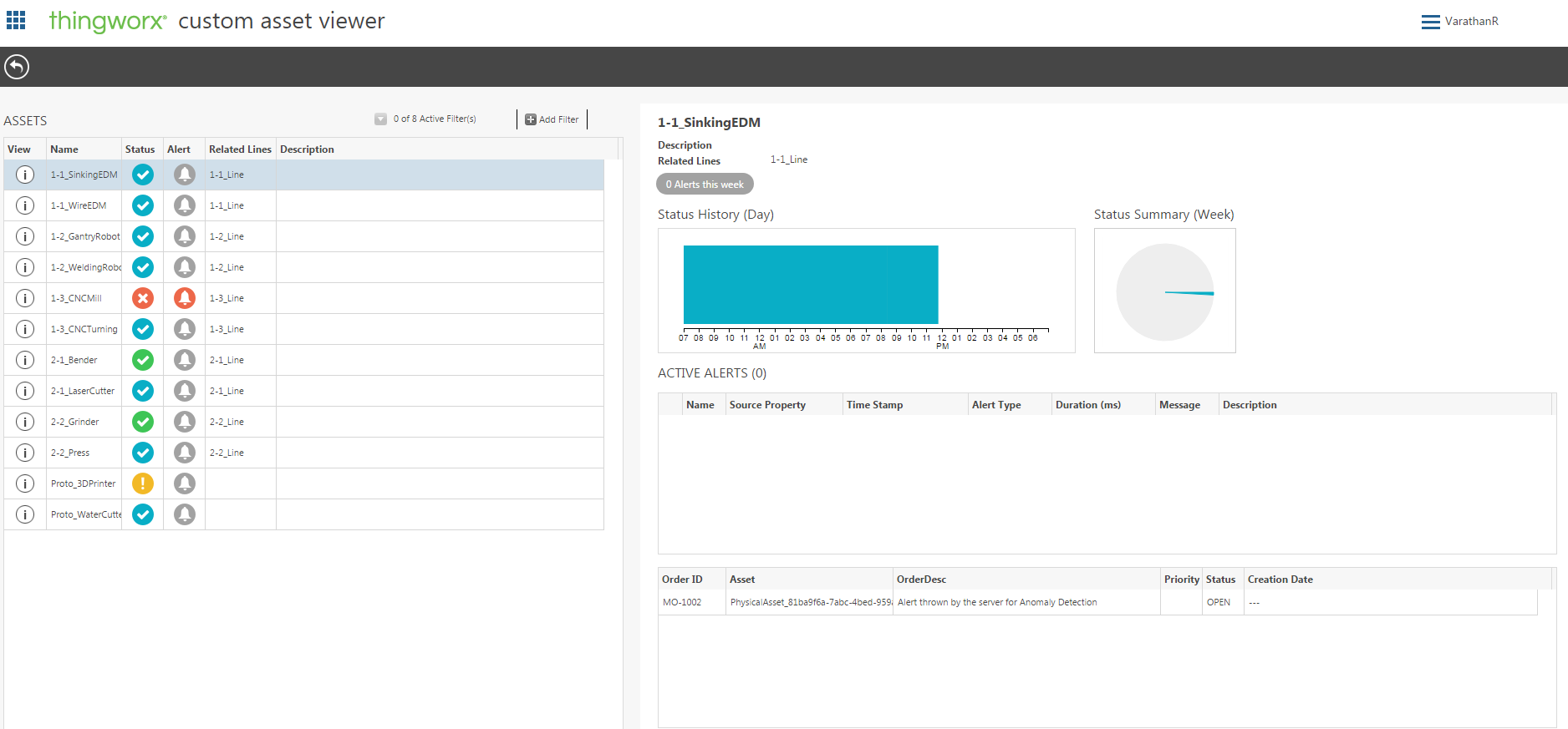

There is also an interesting application to see how I can build mashup similar to this app:
https://learningexchange.ptc.com/tutorial/5651/workshop-for-developers-2-custom-asset-viewer-application
I need to build an app similar like Axeda (with its pre-builit asset management screen and to drill down to each asset/device to see its status, alarms, data values) and I was wondering if I can start from an existing Thingworx app and modify it and go from there?
In the case of asset advisor this seem to be an app so I was wondering how to start creating my own app based on this or other apps available (are they just custom extension with packaged entities (like advisor app) :  Thigns, MediaEntities, Mashups, ThingTemplates, DataShapes, Masters etc.
I would like to build an asset list page with a link to a detailed page like asset advisor app shows:

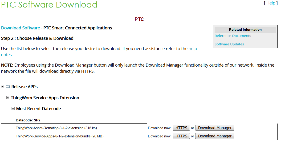

Best answer by slangley
Hi Rad.
Asset Advisor for Services is included in the license for ThingWorx SCP.  Please reach out to the Sales team for obtaining the proper entitlement.  Once you have done so, the software called Service Apps can be downloaded from PTC Support at the following url:  https://support.ptc.com/appserver/auth/it/esd/product.jsp?prodFamily=TWA
Asset Advisor for Services is a starter app designed to provide out of the box capabilities but built with the intent that it can be customized.  The customization guide can be downloaded from the following url:  https://support.ptc.com/WCMS/files/173135/en/ThingWorxManufacturingServiceAppsCust_8-1-0.pdf
Please let us know if you have further questions.
