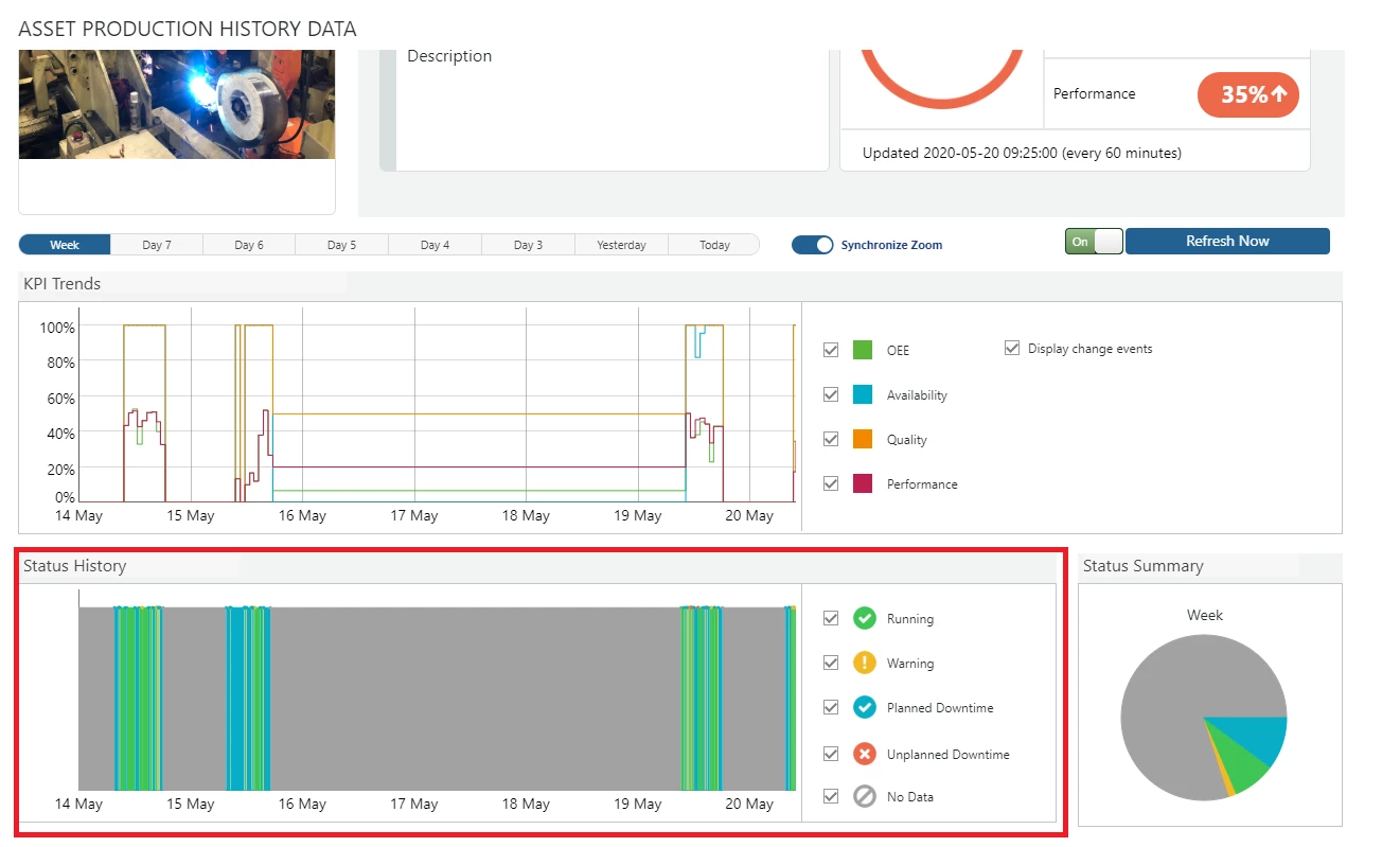

I'd like to modify the Production KPIs status history graph (attached file) from 1 week to 1 month.
Could you please provide me how to modify it.

@Narirat : For this you need to customize PTC.Factory.C_ProductionHistoricalData_[ReleaseVersion] mashup. You can also refer to the customization guide for mfg apps for this

@Narirat  That is for 8.3 mfg apps. For 8.4,here is the link: https://www.ptc.com/support/-/media/3B6F1E4328074DD9A0599DE9D3F1EDAD.pdf?sc_lang=en
