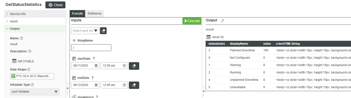

I want to change displayName GetStatusStatistics
Can I change the displayName from this service result?
slangleyAnswer
Support
Jun 18, 2020 8:03 PM UTC
Hi @JackEom.
Depending on what you're doing with the result, you might be able to change the column header name while maintaining the actual name in the backend.  For example, if using a grid widget, the configuration area of the widget will allow you to specify a new column name for display.
If you can provide more details on where you're using the results from the service, we may be able to provide other recommendations.
