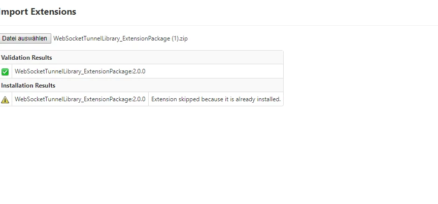

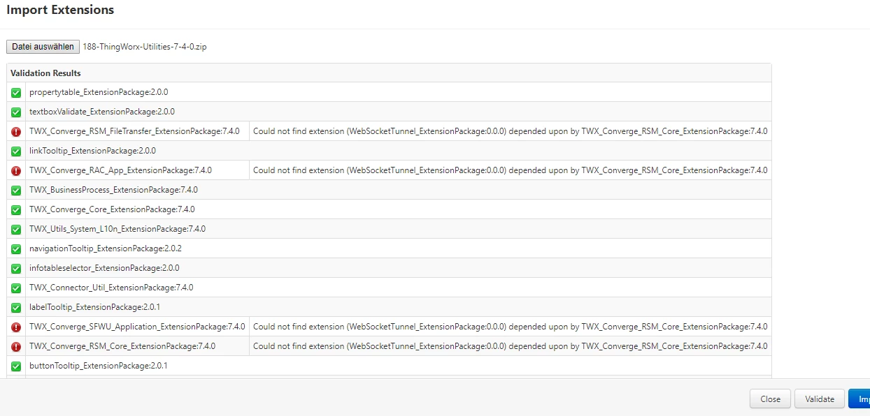

i want to import the Thingworx Utilities plugin into my Installation. The problem is that some extensions of the utility not being imported because of the extension "WebSocketTunnel_ExtensionPackage" is missing (see first screenshot tw).
And when i try to import the missing dependency it says that the "WebSocketTunnel_ExtensionPackage" is already installed (screenshot tw2).

In order to thingworx utilities function properly, the following order need to be followed to import extension
  1. Web socket
  2.  Mail
  3. Google Maps
  4. ThingWorx Utilities
You must install ThingWorx Utilities last in order for it to function correctly. However, now you can download the latest Web socket tunnel extension (Version 4.0.0) from thingworx marketplace and imported again.

The problem is the same. The imported Websocket extension on the screenshot is the newest from the marketplace (v4.0). It still says that the Websocket Tunnel extension is already installted and when i import the Utilities it says that the Websocket Tunnel Extension is missing.
Hello Hannes,

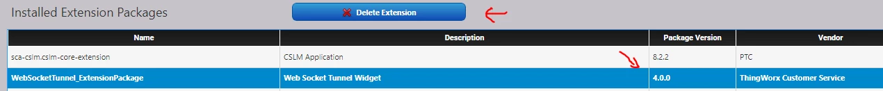

 As per your tw2.PNG screenshot, the websockettunnel extension is 2.0 however what I recommend you to kindly delete this extension from Import/Export > Manage Extension  (attached screenshot)

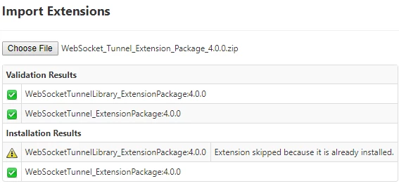

 I have attached WebSocket_Tunnel_Extension_Package_4.0.0 extension.kindly download it and reimported again (attached screenshot) and it should following result.
