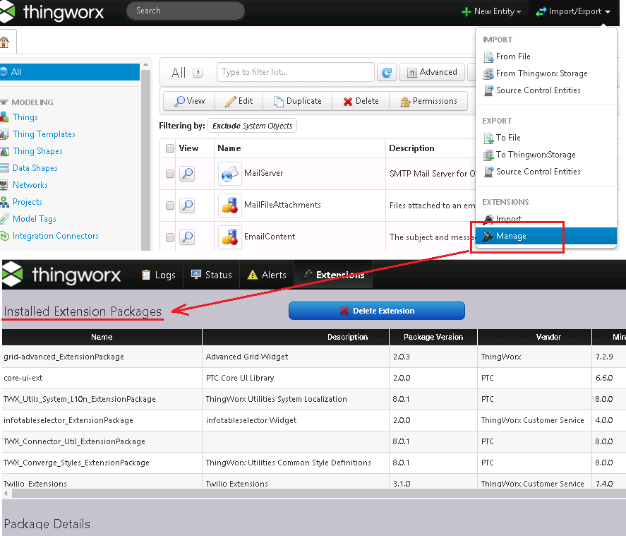

I tried "Import Thingworx manu. Apps as ThingWorx Extension" which is another installation method.
After completing the import, running "Manage" opened [Installed Extension Packages].
Configure Java for Tomcat was completed.

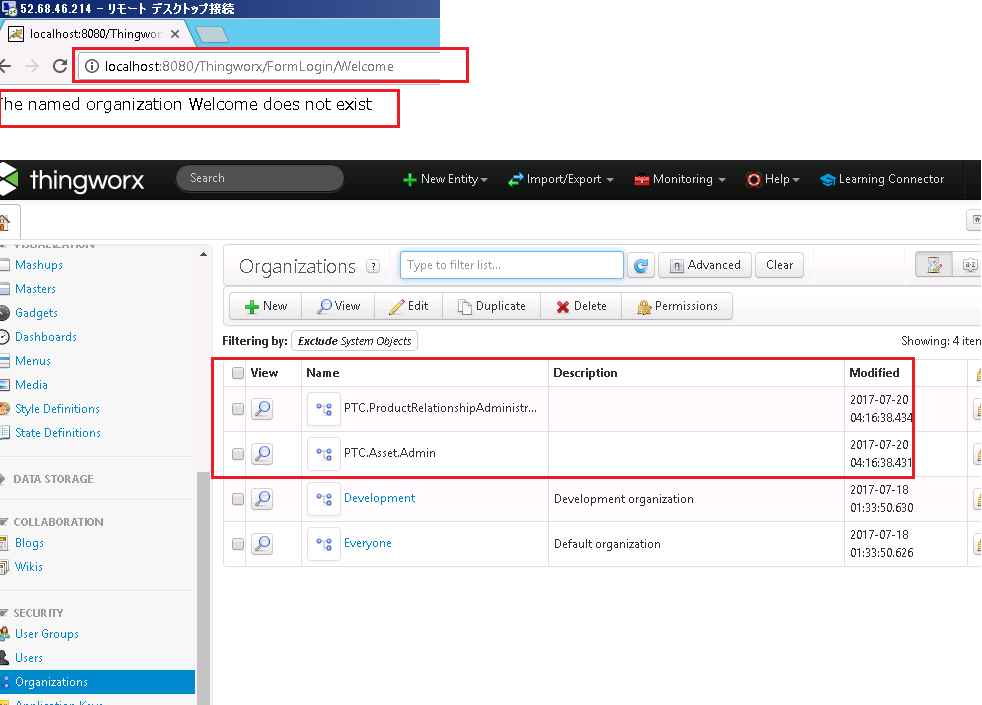

To verify that I can access
Https: // localhost: 8080 / Thingworx / FormLogin / Welcome.
By accessing the above
  "The named organization Welcome does not exist" is displayed, Access could not be made.
I confirmed "Organuzation" on the Thingworx composer, but "Welcome" does not exist.
To find out why it is not possible to access, what should be examined?

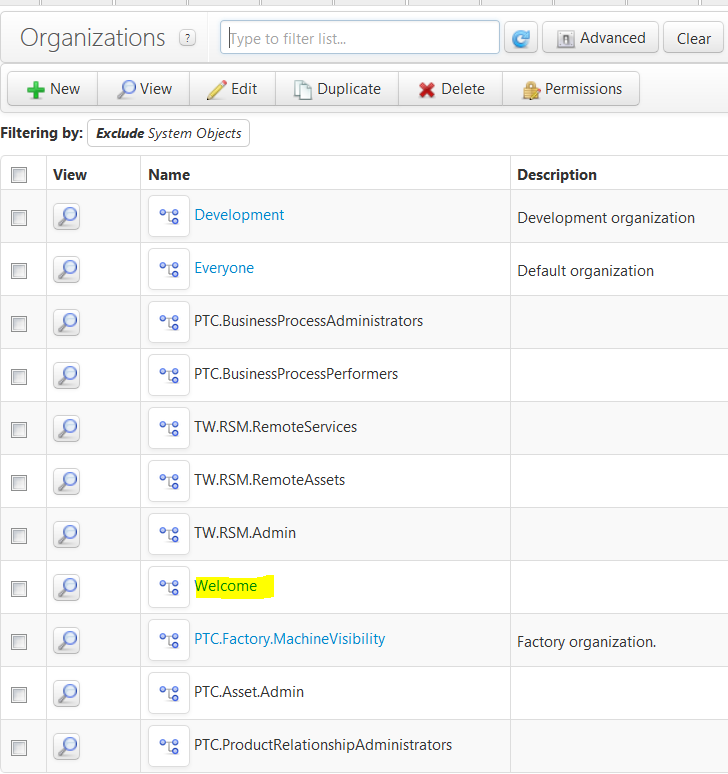

July 24, 2017
Hello Takashi,
The Welcome Organization is auto created once the extension "ThingworxManufacturingApps-8.0.0-00-extension" is imported successfully.
I would recommend you to import the manufacturing apps extension again and check the installation results to see if you are getting some error .
If the import is successful , you will be asked to refresh the composer . Once you click yes , you can check the organizations again.
Best Regards,
Himesh Rajpal

July 27, 2017
Hello Himesh.
Log time no reply, sorry.
As you received the answer, [Wellcome] was not.
I abandoned this extension environment. I created the environment again and carried out Express Install. The result came to [Wellcome] without problems.
Thank you for your response. I would be pleased if you could get an answer next time.
