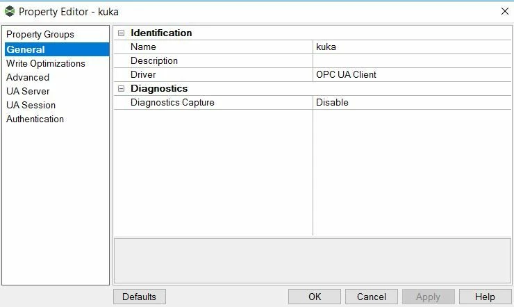

   Versions :
           Windows 10x64
           Industrial Connectivity 8.4.66
           robot KUKA KR900 with OPC UA protocol

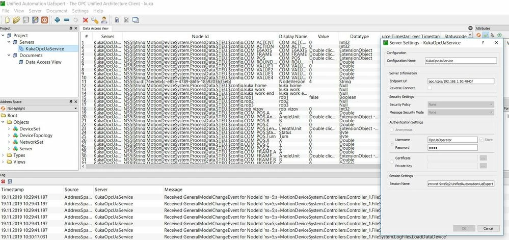

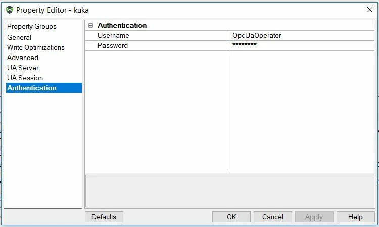

I am connecting the robot KUKA KR900 with ThingWorx Industrial Connectivity via OPC UA protocol.

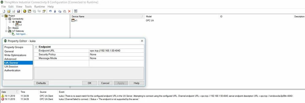

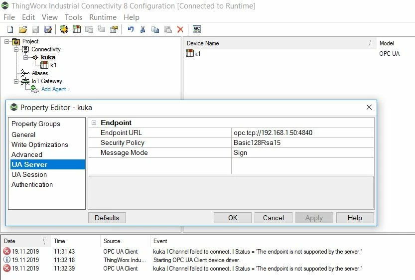

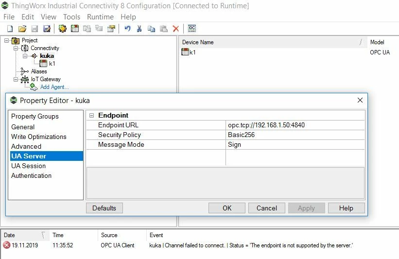

I went through all the possible connection options, but in any case I get the message "End point not supported server".
The "UaExpert" client downloaded from the OPC foundation resource connects to the server without problems.
Connection settings of "UaExpert" and IC in the attachment.
Client authentication is carried out by entering a username and password.

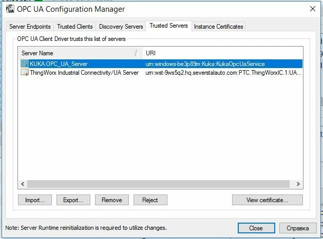

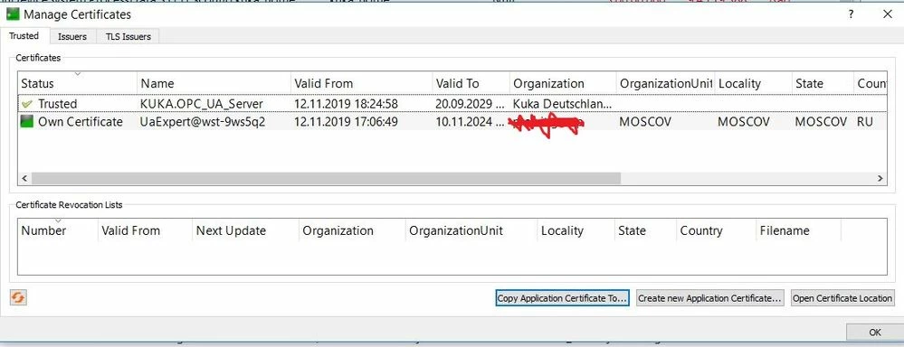

The KUKA.OPC_UA_Server certificate is located in the Trusted Server section.
Thank you, Peter.

I upgraded Industrial Connectivity 8.4.66 to Industrial Connectivity 8.5.67.
In mode:
"Security Policy: None"
"Message Mode: None" - connection established!
In the new version of the program, the problem was solved automatically!
PS. In all other connection modes - an error message appears.
Thanks for the support.
