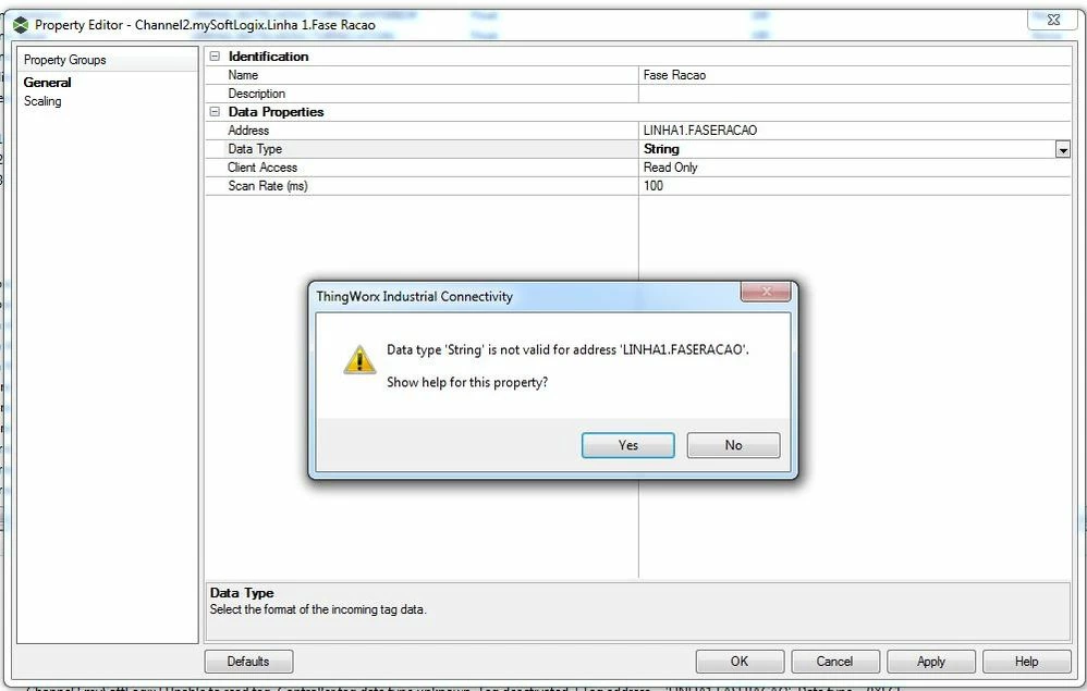

I am using the Industrial Connectivity with PLC Rockwell and I have some TAGs type REAL/FLOAT already communicate work it.
So when I try communicated a TAG type String (my addrees is data type string on my PLC) happens the follow error:

Hi @vangne
That manual did not help me.
I need bind a tag (type: string) because I want show in my dashboard one operator name that is into my PLC. I was able of bind others tag's type (e.g float, interger) but type string I could not.
