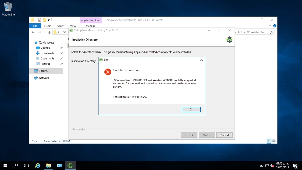

Is possible to install ThingWorx-Manufacturing-Apps-8.1.2-00-Express on windows server 2016?

Greetings @AndonyVelazquez,
At this point of time we do not support Windows Server 2016.
For more information on supported platforms please refer to ThingWorx Manufacturing Apps portal download page and scroll down to Supported Platforms section.
Please let us know if you have any additional questions.

I have the same issue installing on Windows 10 laptop (no server etc.). Could anyone advise on the error?

Windows 10 is also currently not supported.  At this time, the ThingWorx framework does not support Windows 10 which affects all the apps running under ThingWorx.
Regards.
