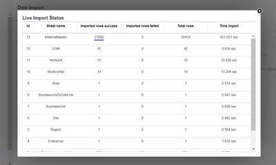

I m importing master datasheet in DPM but facing an issue when it comes to material master sheet.
DPM all of sudden stopped importing and screen was ideal for 3 hrs. No progress in upload/ import of sheet.
so i want to know is there is any limitations of importing rows in DPM?
i am attaching screenshot of Window when importing got stuck.

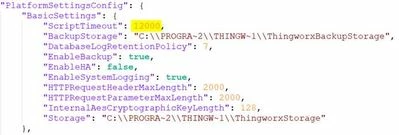

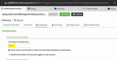

its resolved by   increasing ‘Idle Session Timeout’ in UserManagementSubsystem and ‘ScriptTimeout’ in platform-setting.json file  helped me in  resolving the problem i was facing. Below are the configurations I changed in my local system.
