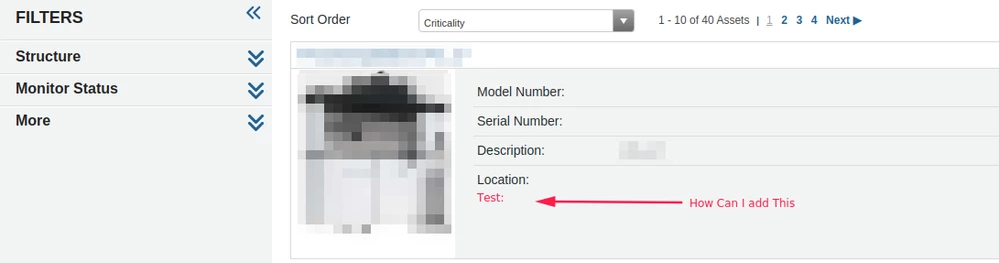

Issue in Adding One more property in Asset Advisor
One more property needed to be added in Asset Advisor... how can it be done ?
and filter based on it..
@c_lowy @paic @slangley @CarlesColl
Thanks.

Hi @pshashipreetham ,
For adding additional properties on the asset detail screen you need to override the mashups and services.
Please follow the steps mentioned on the below help center to add additional properties on the asset detail screen.
https://support.ptc.com/help/thingworx/apps/r9.1/en/index.html#page/thingworx_apps/Customizing_the_Apps/adding_properties_and_fields_on_assets_lines_and_sites.html
Himanshu
