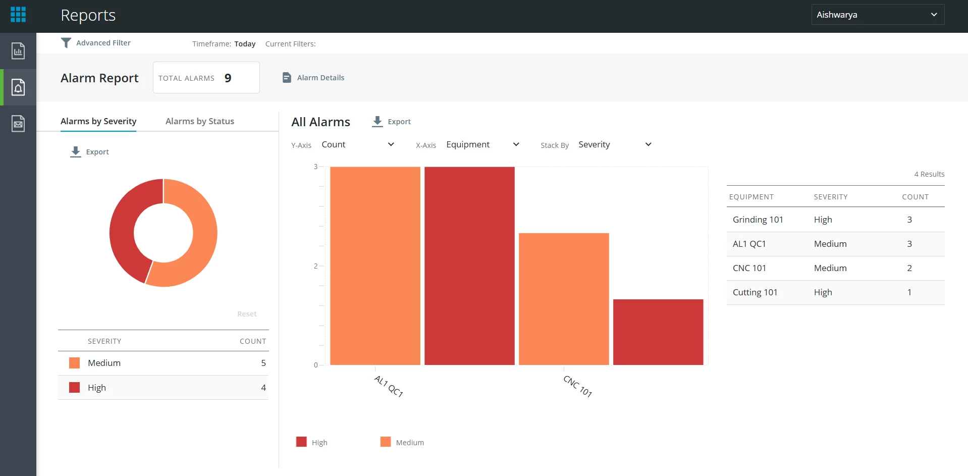

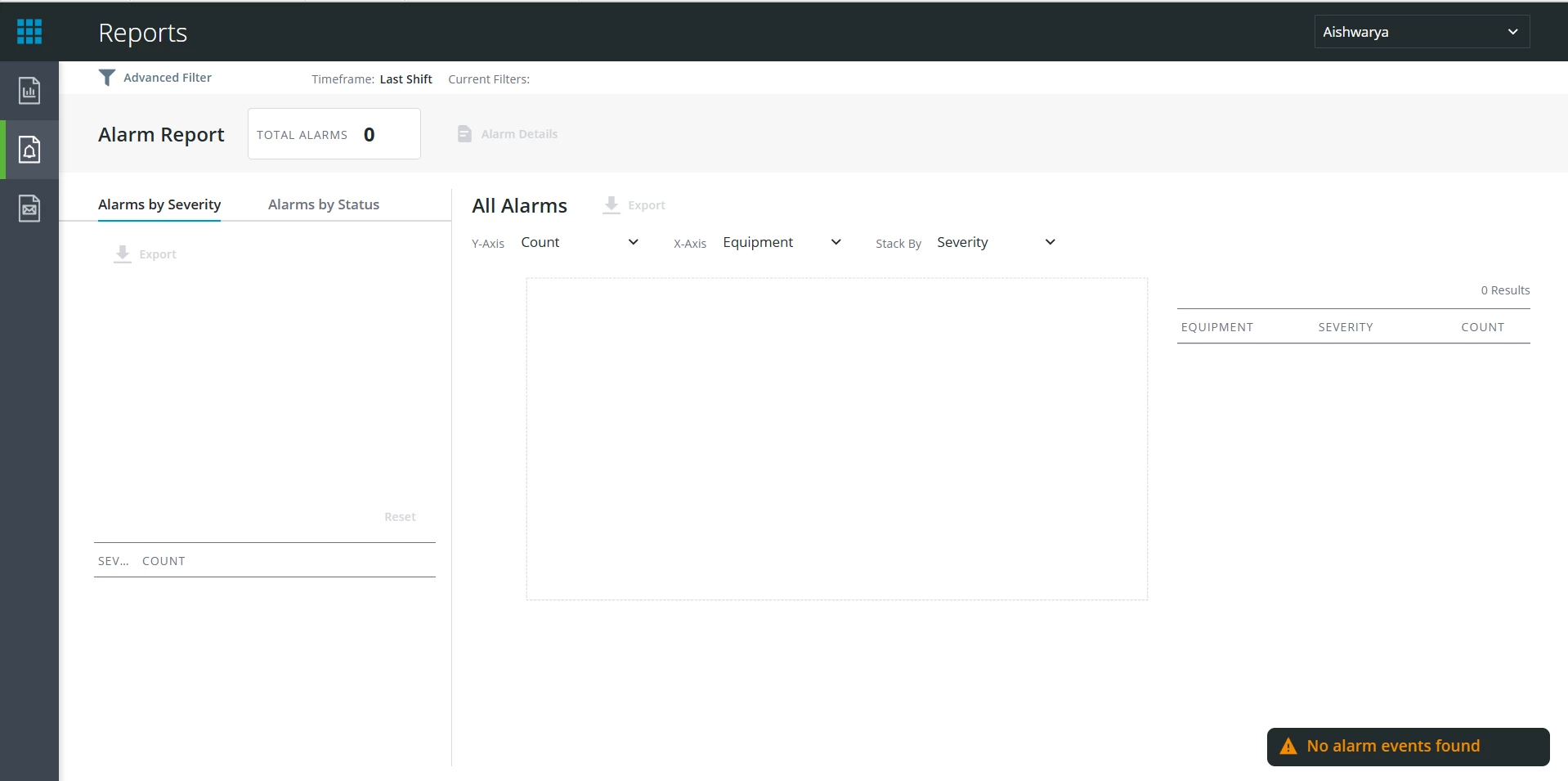

Hello All,
I am currently using AMU and have configured some alarms on the equipment, which are being triggered as expected. However, I’ve noticed an issue with the Alarm Reports.
When I apply the "This Shift" or "Last Shift" filters, the alarm count shows as 0. On the other hand, when I select the "Today" filter, the alarm count is displayed correctly.
Please help in understanding why the count is not appearing for the shift-based filters?

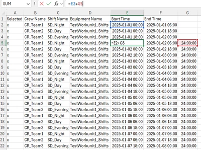

Shift Events absolutely need both the date and the time. If you have 3 shifts per day, then you will have 21 shift events in your week and you must import all 21 records. For a year that's 1095 records.
In Excel, here's an example on how to do this :
- Write example dates & times for your pattern. In my example, I filled the start & end times of my 1st day (3 shifts per day, so 3 records).
- For all following records : in an extra column to the right, write just the time portion that you want to add from the previous records. For example to add 24h (next day), then write 24:00:00 in the extra column.
- For all following records : the time will be [cell containing the pattern's time] + [cell containing the time to add]. In my example, the E5 cell's formula is =E2+G5. You can use similar methods to fill the shift & crew columns (in my example, C5's formula is =C2).
- Use the little "expand" button at the bottom-right of the cells to quickly copy these formulas for as long as you want.
- Pay attention to the days when there will be a daylight saving change, confirm if you need to change the time when you reach those days.
What most people do is they fill the data for the entire year, then set a reminder in early December to do it for the following year. Also most people only do it for a few of their top-level equipments, since their children will inherit from the parents : most people do it at the factory-level equipment(s).
And as a reminder, there must be no gap in your records. If your shift change is at 08:00, then the previous shift ends at 08:00 (not 07:59) and the next starts at 08:00. And if there is a shift where no work will be done, you must still fill it with data but you can use different shifts & crews, like NoShift & NoCrew instead of Night & Team1.

Are you sure that you correctly configured your shifts?
To see the existing shift configuration, start by going in the Configuration -> Equipments screen. Note the displynames of your equipment and all of its parents. As a reminder you can configure shifts at any level of the hierarchy. If an equipment doesn't have shifts then will use the ones from its parent, grandparent, and so on. A lot of people set the shifts at the factory level.
Then go in the Configuration -> Shift And Crew screen -> Shift Events tab. Select the equipment and all its parents. Select the This Month filter. This will show all existing shifts on those equipments. If the grid is empty, it's because you have no shift configured.
If you have access to do SQL queries, you can also try to run this query (change the EquipmentUid at the top) to see if the system can find This Shift for your equipment. If the query returns nothing, then it can't find it.

Hello mstarnaud,
Thank you for your response and detailed guidance regarding shift configuration.
You were correct—I had not configured the shift events earlier and instead created a custom shift table to use across my custom dashboards. Currently, I am exploring the shift configuration feature, but I’m facing a challenge:
  • When defining a recurring shift using only the time (e.g., for a third shift starting at night and ending after midnight the next day), I encounter an error stating, "Shift Events Start Time must be before End Time."
  • To bypass this, I tried including a specific date along with the time, and while this removes the error, the shift gets applied only to that specific day and not recurring across the following days.
Is there a way to configure recurring shifts based solely on the time (without specifying dates), so that shifts like the third shift (starting at night and ending the next day) can be defined properly?
