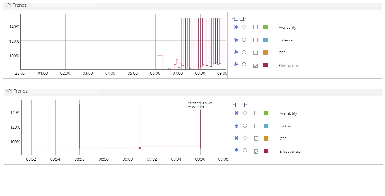

In our development environment dygraph in KPI Trends is working properly, but it doesn't in production environment.
In production environment is drawing vertical lines at the same point where the kpi calculation is printed, see attached image. KPI calculation is 90,74% and it draws the value, but in the same timeline a vertical line that get over 140% is also drawn.

Solved.
It was a mistake in production environment. Two different thingworx server were connected to the same database. After fixing the mistake, it works ok.
