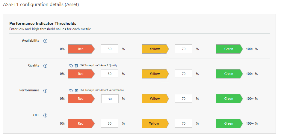

I have made a few configurations on Mfg Apps. But I'm not able to see the Quality and Performance values even though Availability and OEE calculations are shown well. It used to work properly before. Have any other person encountered with this also?

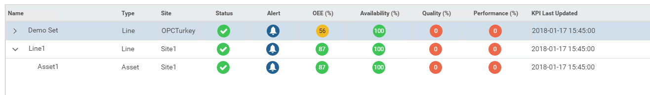

My production advisor screen:
Asset1 performance metrics: quality and performace are coming from KEPServerEX tags.

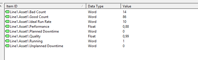

Quality and Performance values can be changed on KEPServerEX:

I know the OEE Calculation is in every 60 minutes by default. That's why I changed it to every 1 minute , so I can see the effects of change in values in a minute. (I do not know if this rate may lead any fault.)
It also came to my mind that it may be related with comma but I cannot use dot instead of comma on Quick Client with KEPServerEX.
By the way when I look into the Asset info on Production Advisor, I can see the 0.88 and 0.99 values on "KPI Trends". Only the main Advisor screen shows them as 0%.

What I am seeing is when the Quality value is being populated from a Tag (rather than using the default calculation method of [Good Count] / [Total Count]), and value is less than 1, the Quality and Performance values are displaying as zero in Production Advisor. However, the values are still being factored into the OEE calculation that is displayed.
This can be observed in your original screenshots of Production Advisor:
OEE: 87%
Availability: 100%
Quality: 0%
Performance: 0%
According to the QuickClient screenshot, the Performance value should be 0.88, and the Quality should be 0.99.
Remembering, OEE = [Availability] x [Quality] x [Performance]
We can see how 0.87 was calculated: [1.0] x [0.99] x [0.88] = 0.87
This tells us the calculations are still being performed for the expected values.
We will need to investigate some more. I will follow up soon with you and this forum thread with an update.

Quick update on this. A Software Performance Report (SPR) is being filed for this issue. Thank you again for bringing this to our attention.
