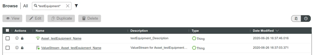

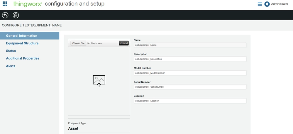

I did a little test. I created an asset in Mfg Apps and then I looked for what entities were created in Thingworx Composer and to which project they were associated to.
1) testEquipment_Name equipment was created
2)I searched for *testEquipment_Name* in composer
But neither of those two entities was associated with a project.
Creating two Project entities for two MfgApps projects seems a good approach. Although it is not as straight forward as I'd like to, I could add those two above entities to a project entity.
But how can I "tell" the extension MfgApps to which project entities to look for? I mean, how can I change between projects from a MfgApp point of view?

From MfgApps point of view, I believe we cannot change between projects. The Project entity is specific to ThingWorx platform, and is intended to use in ThingWorx Composer. Even the publishing of projects to a Solution Central repository is done from ThingWorx Composer.
By any chance are you looking to create and publish projects directly from ThingWorx MfgApps?? If so, I believe it isn't allowed as of ThingWorx 8.5.
