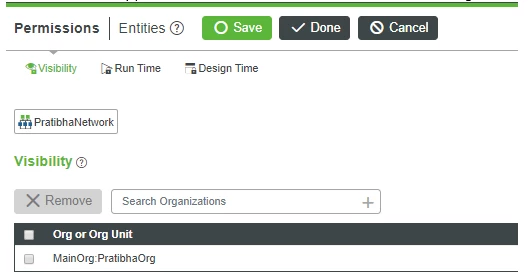

Before creating a context we need to create a network entity.
To create a network entity:
  1. In ThingWorx Composer, select Networks from the Browse pane, and click New.
  2. Enter a name for the new network. This is the value to be entered as the Network for a context on the EquipmentContextSettings configuration table.
  3. Click Save to create the network.
  4. On the Permissions page for the network, select Visibility.
  5. Search for and select the PTC.Factory.MachineVisibility organization. This grants the same visibility permissions to the ThingWorx Apps user roles as are granted in the default context.
  6. Click Save to save the network.

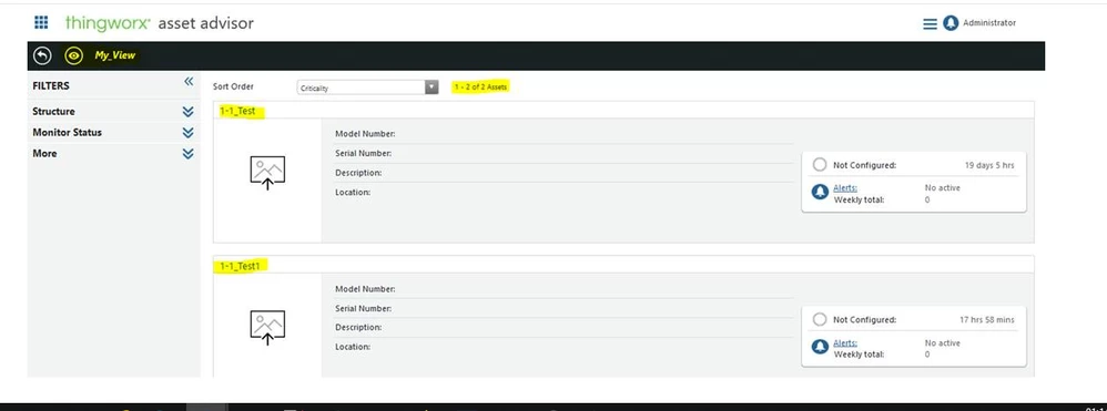

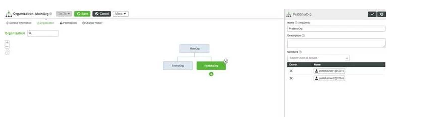

Now to control the visibility of context follow below steps:
  1. Create an Organization say “MainOrg” and add two sub units under the MainOrg.
  2. Create 4 users as “Maintenance manager or any” and add 2 users in each sub unit organization.
        3. Create 2 network for each context view and add 1 or more line & assets in the network
        4.  Go to the visibility permission of the first network and add one sub unit organization & give run-time access to the users or user group specific to that organization.
        5.Repeat the 4th step for second network.
        6. Go to launch point Configuration & create context for 2 different networks.                                                                            7.      Go to PTC.SCA.SCO.ContextManager & execute PropagatePermissions services according the requirement like PropagateUserGroupPermissionsOnEntities, PropagateUserPermissionsOnEntities.
