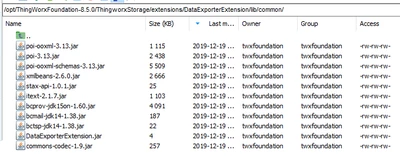

I can't import Manufacturing Apps.I installed DataExporterExtensionPackage.zip and then MED-61227-CD-085_F000_ThingWorx-Apps-8-5-0-extension-bundle.zip but I get an installation error. I send the Thingworx log files. Thank's

Hi @abhkumar_274615: My Thingworx version is 8.5.0. I imported MED-61284-CD-085_SP2_Remote-Access-Extension-1-2-0.zip but I got this error "RemoteAccessExtension:1.2.0 Minimum Thingworx Version [ 8.5.2] requirements are not met because current version is: 8.5.0".
Then I imported version 1.1.0 without errors. I unzipped the file MED-61227-CD-085_F000_ThingWorx-Apps-8-5-0-extension-bundle.zip. But when I validate ThingWorx-Apps-8.5.0-02-extension-dependencies.zip, I got this error: "TWX_Converge_Core_ExtensionPackage:8.5.0 Checking deployed extension JARS conflict(s) detected [package: TWX_Converge_Core_ExtensionPackage]. Check application log for details".
In the log file I attached, there is a jar conflict. I have the extensions listed in the image. Can I delete them and then import or can I have a conflict with what is already installed? Thank's

Hi: To install ThingWorx-Apps-8.5.0-02-extension-dependencies.zip I had to rename four jar files on the Thingworx server, located at /opt/ThingWorxFoundation-8.5.0/ThingworxStorage/extensions/DataExporterExtension/lib/common/
poi-ooxml-3.13.jar
poi-3.13.jar
poi-ooxml-schemas-3.13.jar
xmlbeans-2.6.0.jar
After the change, I had to restart tomcat and then Linux to start Thingworx.
Then I installed ThingWorx-Apps-8.5.0-02-extension.zip with the warnings indicated below, but the installation was completed!!!
"AppHomePage-extension:8.5.0               Extension Package [AppHomePage-extension] is trying to override existing entities: [Role:ModelTagVocabulary] [Relationship:ModelTagVocabulary] [PTC:ModelTagVocabulary]"
I don't know if it is the right solution but it can help someone.

Hi @anaclos.
Per the case notes, there were some conflicting .jars.  After stopping Tomcat, removing the conflicting .jars, and restarting Tomcat, the extension imported successfully.
If you agree that this was the solution to your problem, please mark this post as the Accepted Solution for the benefit of others experiencing similar issues.
