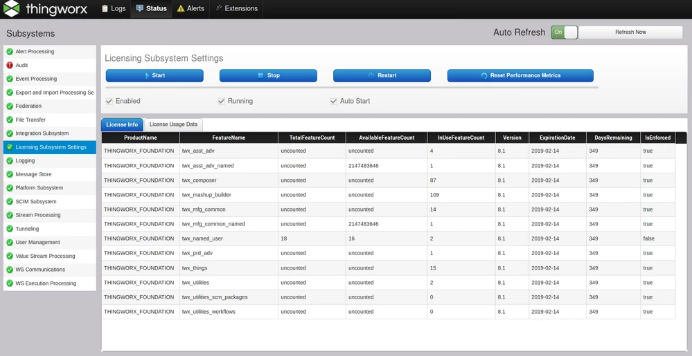

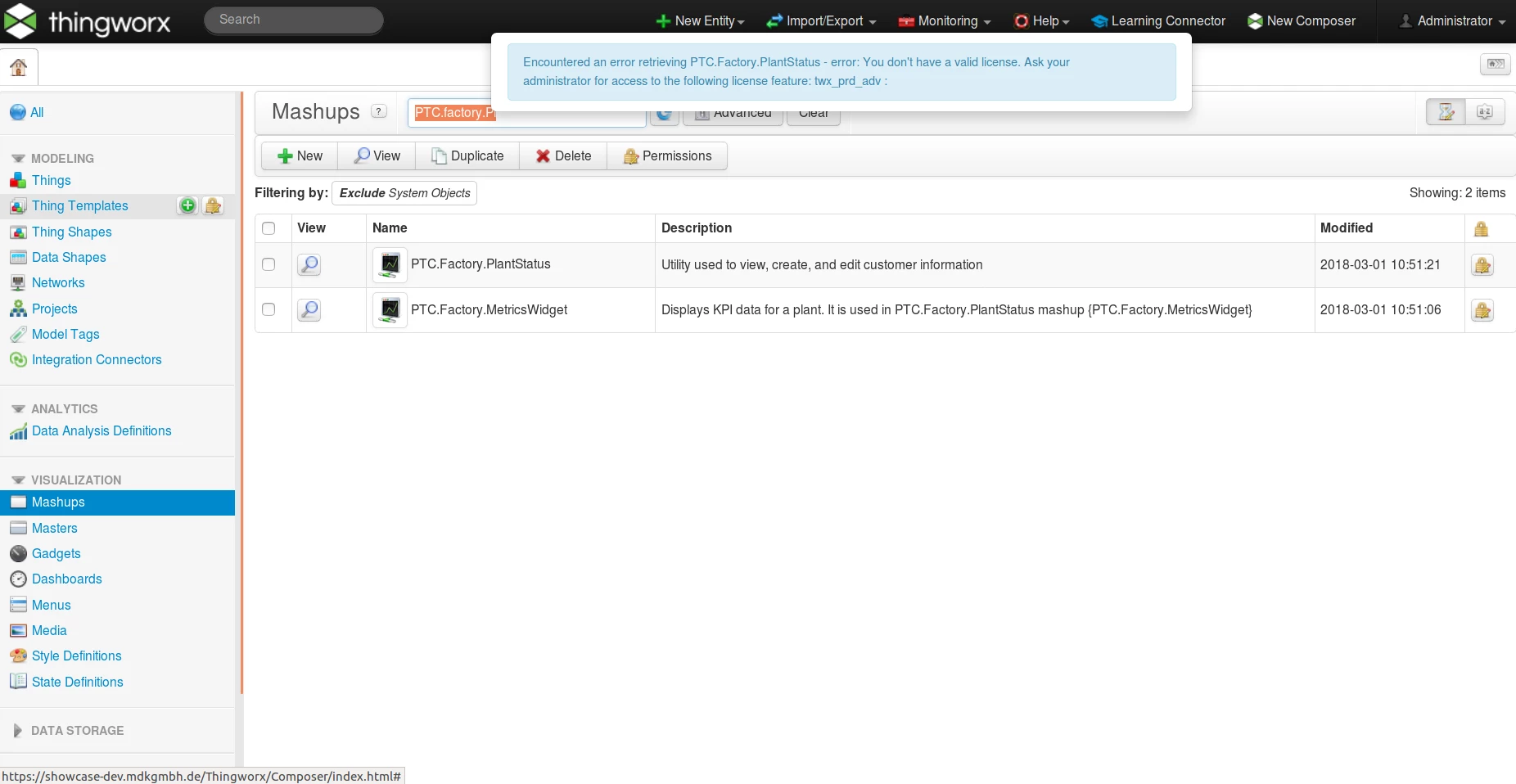

I am trying to install Thingworx Manufacturing App. The "Production advisor" is missing. Does anyone know how i can fix this?

This is usually the result of a licensing issue.
We would first need to validate your entitlements but I would need more information to do so.  If you can please update your profile with email address, company, etc., I will be able to determine if we would need a case for troubleshooting this issue.

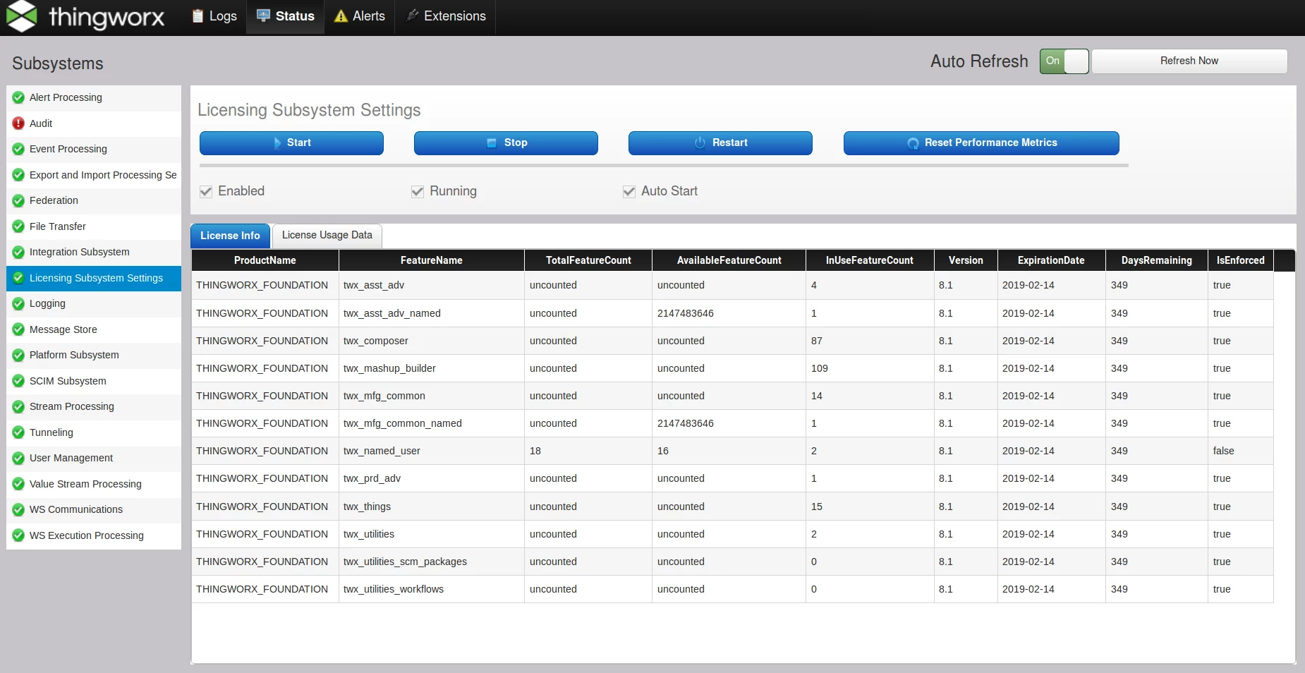

Thanks for the suggestion. I was logged in as Administrator. I also tried adding Admin to that role and it didn't work.
PTC checked my TWx license, and it was clear that this is a licensing problem.

yes. It was a licensing problem. Everything is running fine now.
