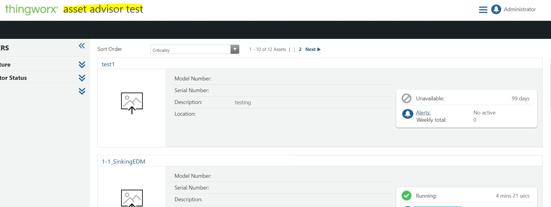

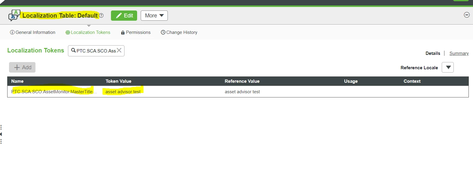

You can change the title name of the asset advisor in the "Localization Table" from the thingworx composer.
The localization token responsible for the asset title is "PTC.SCA.SCO.AssetMonitor.MasterTitleLabel".
Kindly refer to the images attached.
