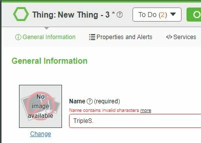

Hi, in the Thingworx Application Development Guide 1.0 on page 75 it's given Naming Guidelines for Reusable Components. It states to use a dot in the namespace.
When I use a dot I get the message: "Name contains invalid characters"
Are there any way around this or is it a recerved character for PTC developers?
Thingworx 8.4.1-b2126

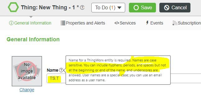

Hi @RagnarRoestad ,
Dot is allowed in between name but not at the beginning or end of the name. PFB screenshot for reference.
