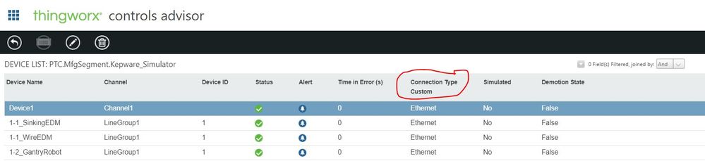

I am following the example in the Thingworx-customization-guide-8.4.1 on page 94 the example shows how to change the device list that is displayed in the Control Advisor.
I am however unable to change the grid in the mashup. I tried doing it on the existing mashup as well as a duplicate. In both cases I am unable to save any changes.

Hi @AndreaSteyn ,
I tried to use PTC.Factory.KEPServerEX.C_DeviceList_[ReleaseVersion] on my machine and it is working fine.
I made some changes in grid header name in custom mashup and changes are visible in the mashup runtime.
Capture
Can you please double check your changes.
If possible please share your duplicate mashup for further investigation.

Hi @hchanana ,
I restarted my Thingworx application and console twice. After the second time I was able to save the configuration.
Has this ever happended to you? I have picked this up with some of the mashup's as well. I make changes and save it , I receive the confirmation that the data was saved but when I go back to the mashup later the changes weren't saved and the mashup looks the same as before.
Is this a known issue in Thingworx 8.4?
