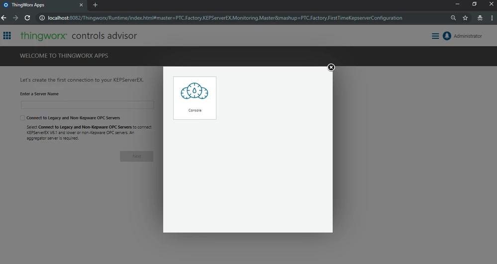

I am facing problem in Manufacturing Apps. I imported all extension in thingworx 8.2 version and after accessing app it show me only console window option not other. i am not getting any kind of error/ exception while importing extension .

Hi @RockLala ,
You need to add KepServerEX details for the first time  and then you can see the tiles in manufacturing apps console.

But still its is not show other option... first time its open configuration module and the after clicked on menu option only console module option is visible.
anythings  else I need to do ?

Hey @RockLala
is the user that you use in the Administrator group?
The tiles have permissions and the user has to be in some special user groups.
Administrators should have access to the tiles/apps without any configuration.
