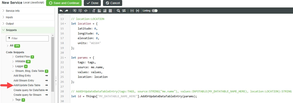

If you use a DataTable instead, you don't need to call the DatabaseThing : you can use the "Add/Update Data Table" Code Snippet to give you an example of how to insert into a DataTable directly :
