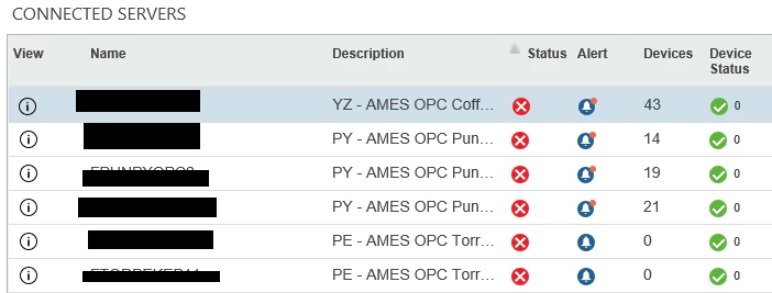

Hello!
It's me again, this is because after i reinstall thingworx in a ubuntu server, with a postgresql database (everything looks fine) the OPC servers i used to monitor before are marked in a red cross in the Status column, and the Device status show a "0" in green.
It looks like after the reinstall, the application cannot connect to the OPC Servers.
Thanks in advance!
Best answer by supandey
Hi @rodolfocorral so if i get it right you are connecting these servers to ThingWorx via OPC DA Extension? I'm not sure how you were authenticating, may be the AppKeys need to be checked validating the authentication.
Also, I would check for the ThingWorx logs in the ThingworxStorage/logs folder to see what sort of error is being reported.
August 29, 2018
App key was incorrect.
The bad thing is that i need to recreate an appkey each time i restore the server where the app resides.
