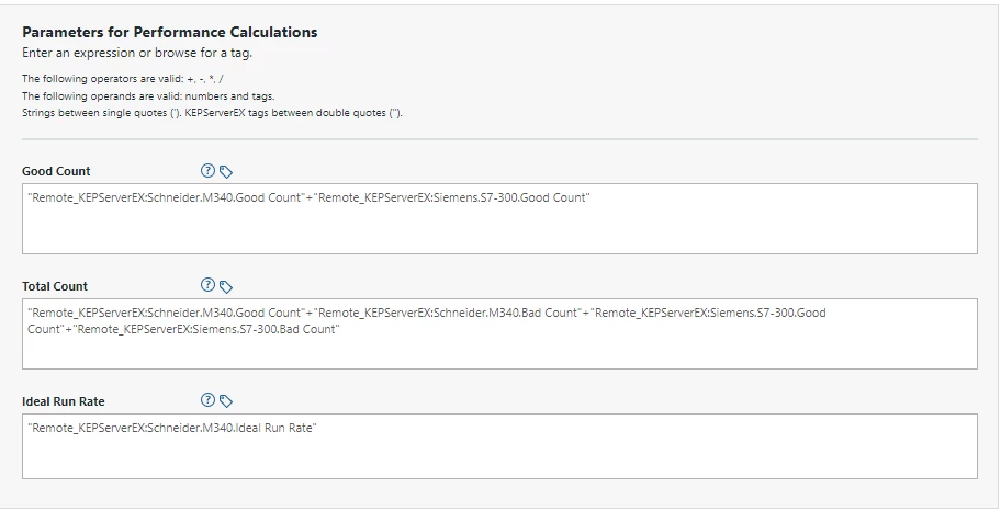

The parameters for performance calculations of Demoset Line is known following picture:
I have not configured quality and performance parameters using any tag:

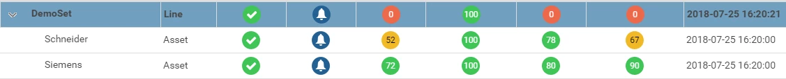

Then I can not see performance, quality and OEE values in the production advisor:

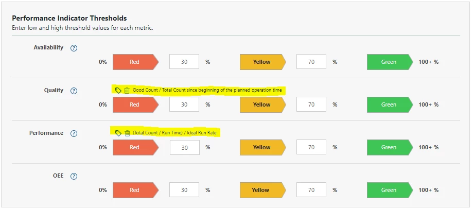

However, when I have configured the performance metric from "Performance Indicator Thresholds" section, KPI calculations become successful as seemed at Siemens and Schneider.

You can configure custom performance metrics for your equipment by entering information for your performance thresholds and calculations using the KEPServerEX tags.
If you don't configure  quality and performance parameters, it will take the default parameters (default calculation for each metric can be viewed by clicking ?  next to each indicator). However Quality and Performance can be overridden by clicking and selecting a KEPServerEX tag directly.

Firstly, thank you for your reply. I guess I could not explain the problem. The problem is that the value of quality and performance parameters have seemed as zero unless no tag has not been assigned directly even though it is expected using "Parameters for Performance Calculation" values.
I have specified good count, bad count and ideal run rate parameter; however, performance metrics are not calculated as default. That is the problem.

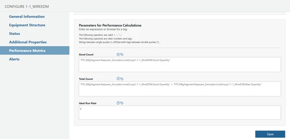

Ideally it should work if we are specifying default values in Parameters for Performance Calculations.
These values are calculated as per the period specified in KPI Calculation Period under Configure Asset -> General Information.
Quality = Good Count / Total Count
Performance = (Total Count / Run Time) / Ideal Run Rate
You can also check these values on the Kepware/external system and see if these are changing.

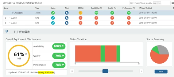

It is working as you can see in the below screenshots. In this I changed the KPI Calculation Period to 3 minutes, so data is refreshing every 3 minutes.
These values are updating with the default tags. The Ideal Run Rate is how many parts can be produced per minute. This is a static value.
