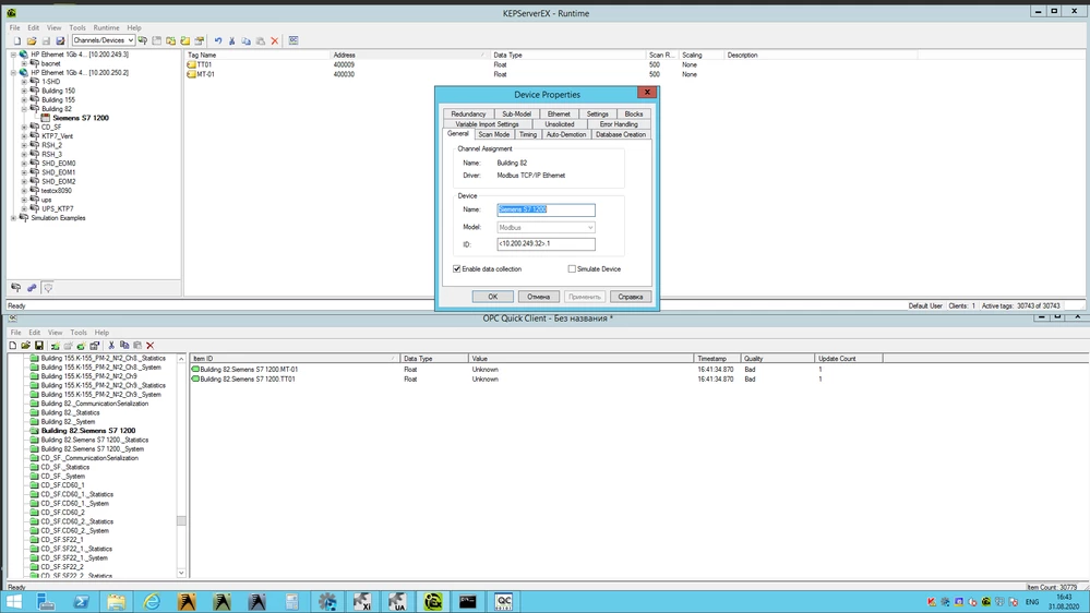

Hello!
The contractor performed work on connecting temperature sensors via the SiemensS71200 controller to the SCADA system via the Modbus TCP\IP Protocol. But they made the connection directly, bypassing our existing opc server.
I'm currently trying to add this controller to our kepserverex 5.13, but it doesn't work. I always get _FailedReads in the _Statistics tab.
In this case, the controller is pinged.

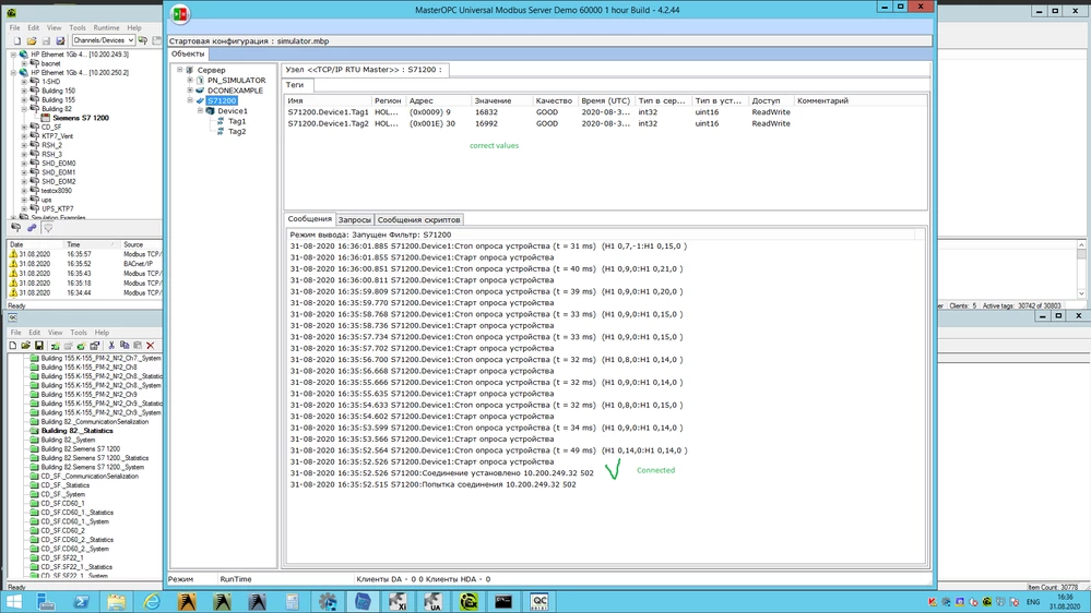

Moreover, I get correct responses from the same ip address and modbus addresses in the opc server of another manufacturer.
I don't know what I'm doing wrong. Port: 502
