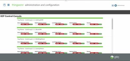

I have followed all the instruction and step until I found a problem in Step 4: Monitor Servers, Assets and Devices, right after I open the Custom Control Advisor Menu it show error like this picture below :
Looking back to Step 3: Configure Factory Simulator Data, all instruction until load data-0.twx, in ThingWorx Composer, results in a successful message.
When I check ApplicationLog in Monitoring in Sidebar Menu, it shows:
[context: com.thingworx.webservices.context.HttpExecutionContext@5efc02c0][message: Execution error in service script [ReadProperty] :: Connect to 127.0.0.1:39320 [/127.0.0.1] failed: Connection refused: connect]
I check in controller service script and there are 6 scripts, one of the is ReadProperty as mention in the error, but no clue which one is the suspect.

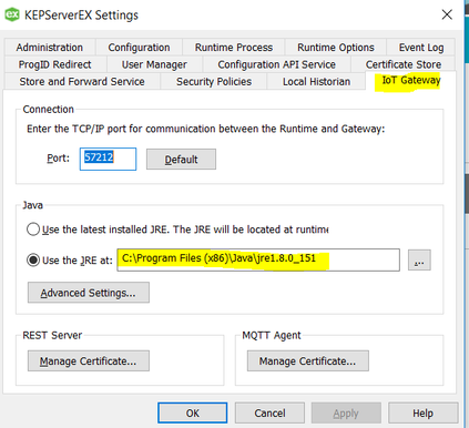

This issue usually occurs due to 32-bit Java missing on system.
Please install latest version of 32-bit Java JRE (or JDK) for the relevant platform running KEPServerEX and change the KepServerEX settings so that IoT Gateway point to 32 bit JRE. PFB screenshot for reference.

I not to understand why, but reinstalling the java and reconfigured the setting to installed JRE works, although it is the same JRE. but many thanks.
(I have installed ThingWorx 8.0 before in my machine but then uninstall it, and change to this Manufacturing Package. Maybe have some unclean data or somthing)
