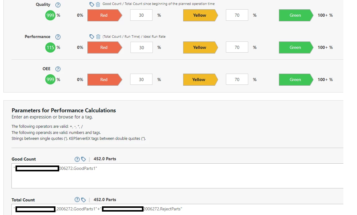

I am trying out Manufacturing Apps. All data is from KEPWare. I have set up performance metrics. Good Parts and Bad Parts count both come from Kepware and looks right. The total count is calculated using Good+Bad and looks right under Performance tab. Everything updates smoothly. However, keep getting Quality numbers all over the place from 2000% to 60% The Total Count under "Monitored Properties" is wrong, and is different from Total Count when setting up "Performance Metrics". Please let me know how to fix this problem. KPI is calculated every 5 mins.

Hi @zackp ,
Can you please share your ThingWorx and Manufacturing Apps version.
Also please share the screenshot for additional property for total count property along with the source (Tag bind to kepserver) of the affected asset.

what is your value for Ideal run rate?
Could you send a screenshot of your configuration in the apps?

Ideal run rate is 20.8 per minute. As shown below, the numbers shown for Good/Total Parts are right; but the Quality KPI is wrong.

you said that the total count in monitored properties is wrong. could you send a screenshot how its looks in the system?
