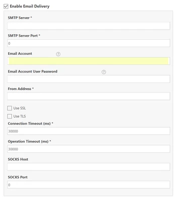

Questions about configuring notification delivery
There are some questions for setting up the smtp server.notification_delivery.png
What information does the From Address need?
What does SOCKs Host information mean? Detailed explanation is required.

Greetings Yonkim,
The From Address will be the email address that is to appear in the From field of the email message and SOCKS host information are to be used only if you are using SOCKS protocol to communicate between client and server .
Basically Socket Secure (SOCKS) is an Internet protocol that exchanges network packets between a client and server through a proxy server.
If you are using SOCKS proxy server for communication , then you need to provide the host name and port number.

Adding to Himesh's response, this information is also available in the Configuring Notification Delivery section of the ThingWorx Manufacturing Apps Setup and Configuration Guide 8.2.
