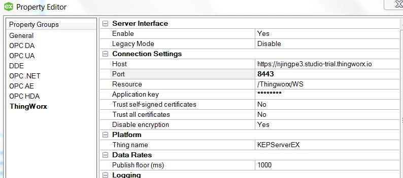

I have the same problem,
I have access to my composer by : Experience Service URL and port 8443
how can I find my instance to connect KEPWARE with thingworx
Thank you

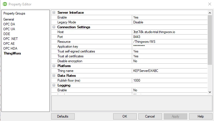

Check the first photo from the attachments, this is how I have it configured and working now.

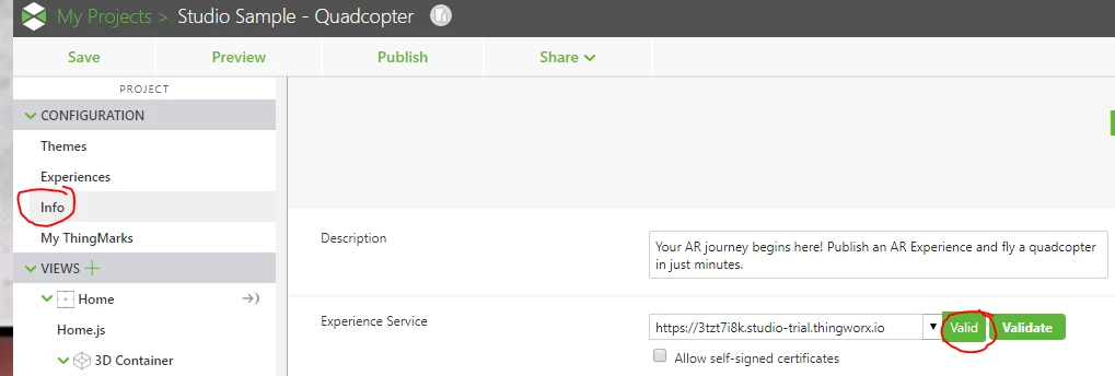

I think you will have checked it - but to make sure - check your "Application Key" and "Thing name". Secondly maybe it helps to delete "https://" from your host. Try to trust all certificates, I needed to do that to get my connection working so. Lastly try to validate your host in ThingWorx Studio, check the second photo from the attachments. Your host needs to be validate to work, in my experience.

Hello 😄
It is the one I've shared in the first post ... (the one with whom I can connect to the composer)
https://njingpe3.studio-trial.thingworx.io:8443/Thingworx/
Thaank you for your replay !!

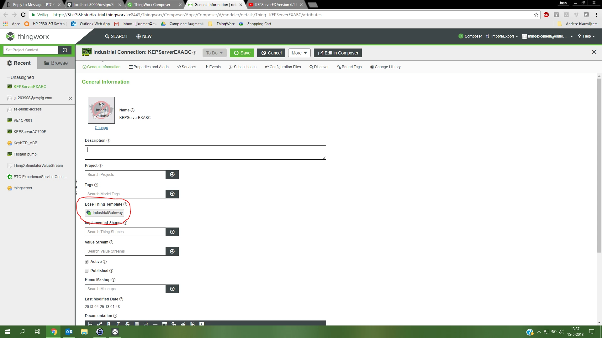

I forgot to tell you some things. First make sure to check the "base thing template" from your Thing is set to IndustrialGateway, see the attachment. And maybe this webinar will help you: https://www.youtube.com/watch?v=MuQRXVpW9Do the tour through KEPServerEx starts from 21:50.

I want to thank you for your support, It works ... 😄 😄
I've tried with my localhost (using Thingworks Manifacturing Apps) and it works,
and now I tried what you suggest, and i gave some results 😄
Thank you !!
