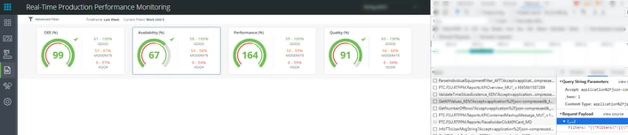

in RTPPM 2.0.3 the only way to show the KPI report mashup is through the UI interface. IF you want to retrieve the KPIs you could use service PTC.SCA.SCO.KPIEngineUtilsThing/Services/GetKPIValues_KEN instead:
The service takes a JSON input to specify the equipment and the time period
"Filters": [{
"FilterCriterias": [],
"EquipmentUID": 8
"QuickTimeIntervalUID": 11,
"QuickTimeIntervalName": "LastWeek"
