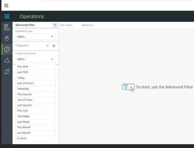

Hello, I've been trying to find the data tokens for the quick time picker dropdown list in Downtime events dashboard in RTPPM but unable to do so. I need help in locating these tokens so I can add their translations in the respective localization tables. Thanks!

These time intervals don't use tokens. They're stored in an SQL table called QuicktimeInterval in the RTPPM database. There's a Name and Displayname column, you must not change the Name (it's the way the program recognizes it), but you can change the Displayname : it's how it appears in the screen. You will need to write SQL queries to read & update the Displaynames.
Sadly this does mean there is no language-dependent translation. All users will see the same words, no matter which language they use. We have request PSPT-76679 to change the Displayname name system into Tokens for these time intervals, but this change has not been started yet.
