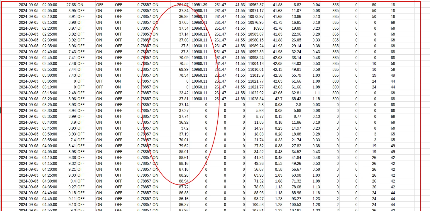

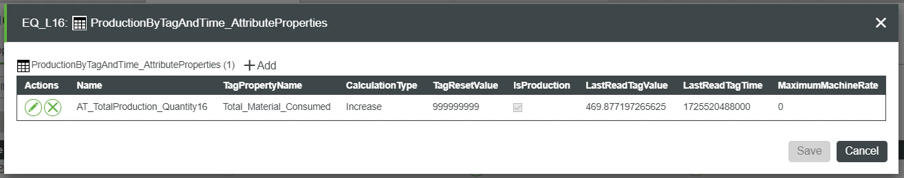

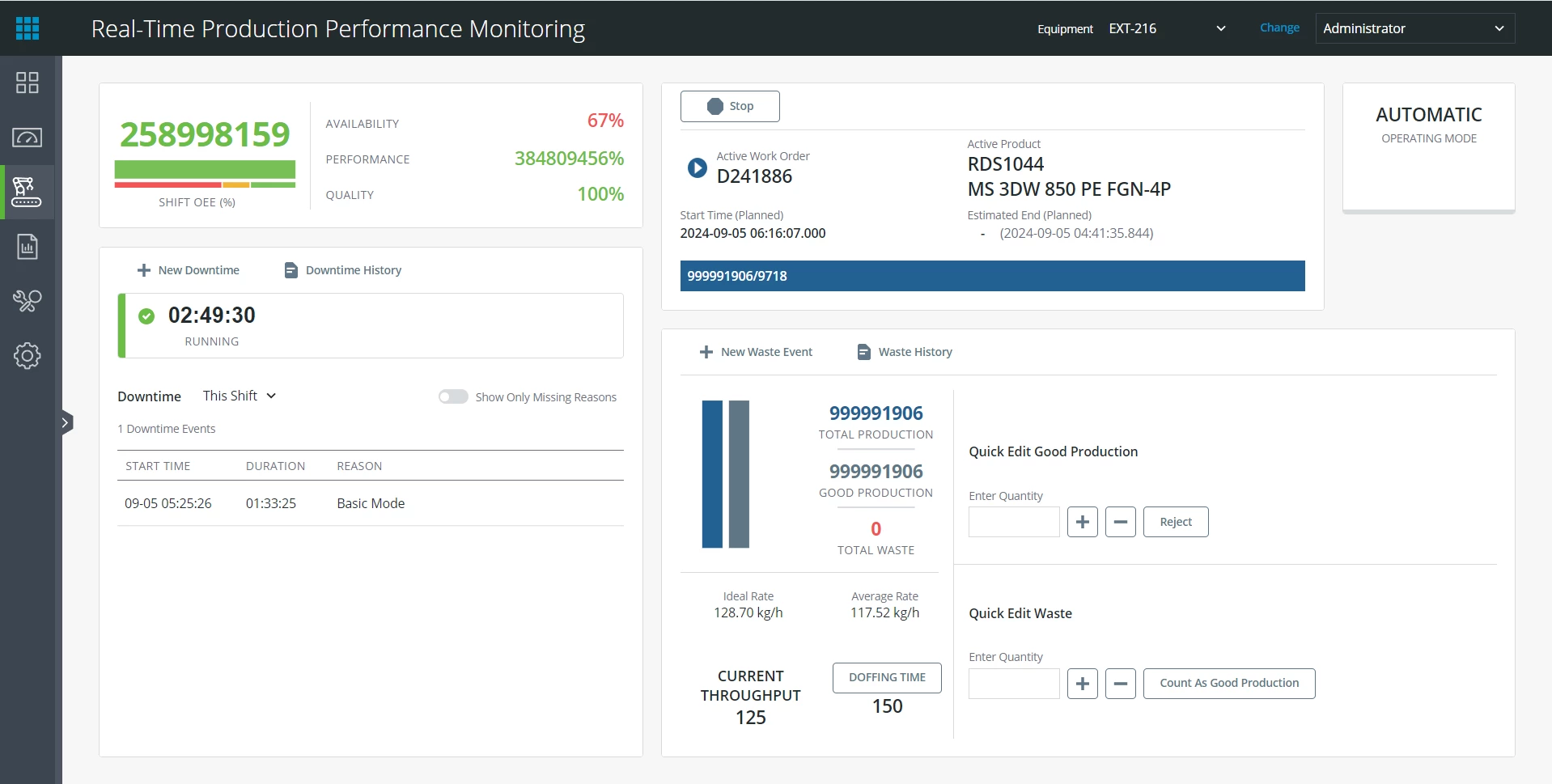

RTPPM Production Quantity attribute is linked to machine's consumed tag. This tag value can be reset by the operators during shift change or any other reason. When tag value s reset, Total Production Quantity increases by 9999999, which is "TagResetValue" of  "ProductionByTagAndTime_AttributeProperties" property. How can I prevent this?
Also when I enter a MaximumMachineRate value, Production Value never increases. That's why I'm not using it.

Hi @oaslan , the TagResetValue setting is optional for production tags that always reset at a specific overflow. In the use case described above you want to set the TagResetValue to 0 (zero). Please find more information in the ThingWorx Apps Help Center .
