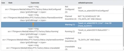

I have installed the Manufacturing Apps in version 8.5.2 on a fresh ThingWorx instance (8.5.3). I have noticed that the status icons in "Configuration and Setup" are not displayed. Here is a screenshot where incorrect quotes before the <span> tag have been removed via the Chrome console.
Is there a fix for the OOTB mashup provided by PTC?

Hi @pjahn ,
Its a known issue with Thingworx 8.5.3 and later versions. It is already being under consideration by R&D team and will be fixed soon.
Himanshu
