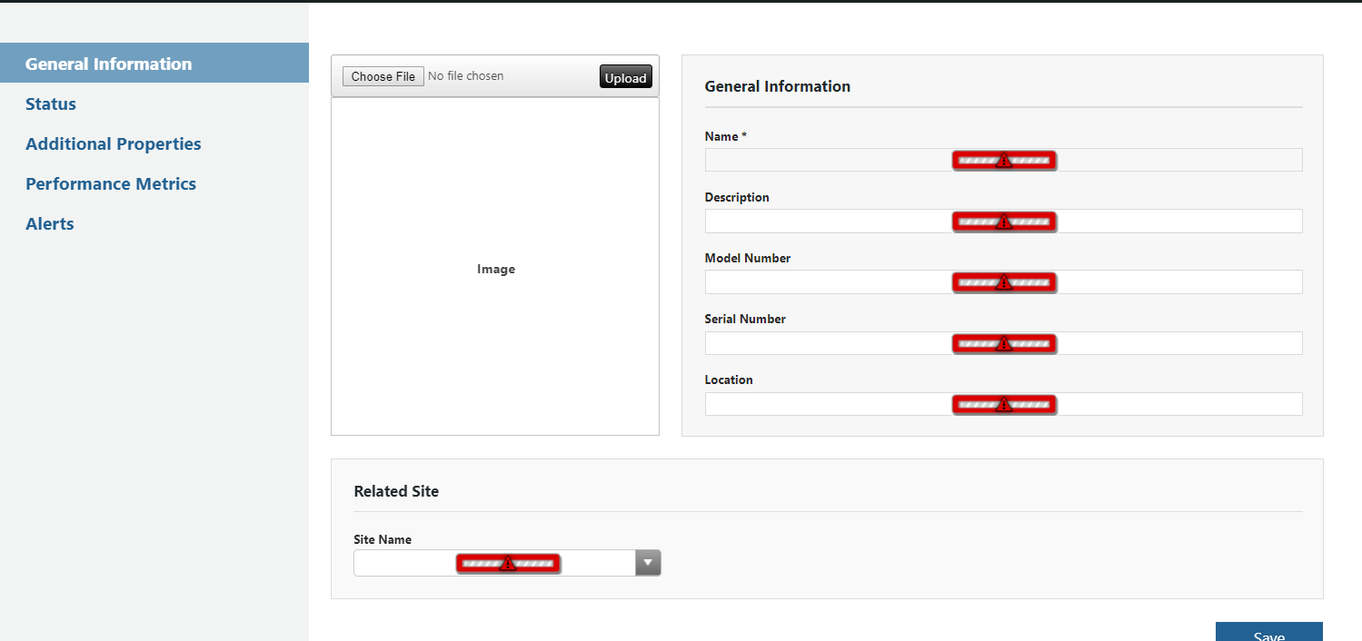

For example, if you want to add new properties to all your line, you can implement additional Thing Shape which should make it available to all your line. Same thing with services. On the UI, you may have to expose these properties depending on your case.

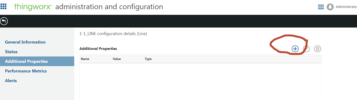

If you want to add different properties to different lines, it can be done from the UI as shown below.   These properties are at Thing Level.

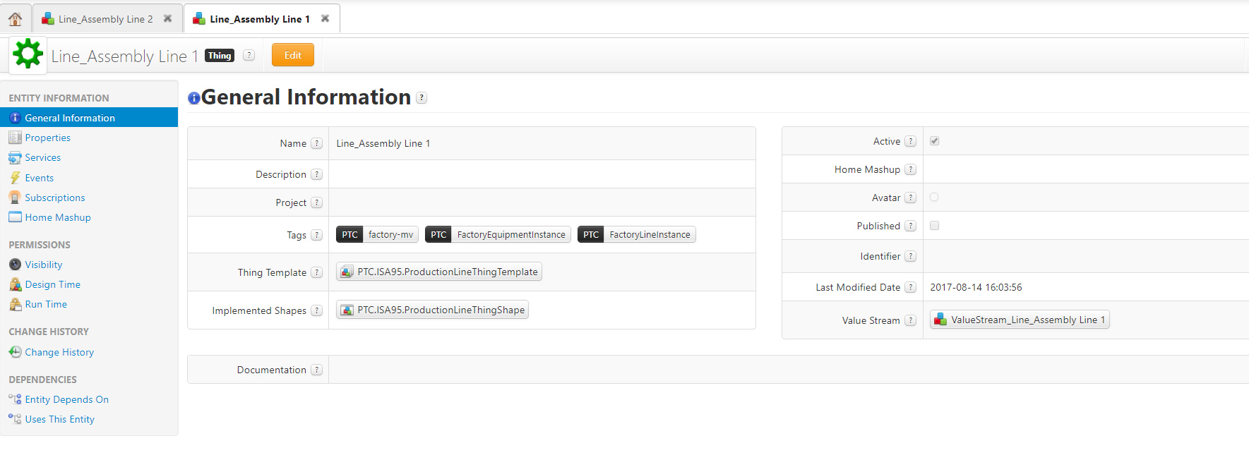

If I understand your question correctly, you would like to duplicate the Lines, which inherit from the 'PTC.ISA95.ProductionLineThingTemplate'. This is not possible withing the Manufacturing Apps UI itself. However, for Premium licensed users, it is possible to use ThingWorx Composer to duplicate a Line, which would also duplicate all of its inherited templates and Dependencies.

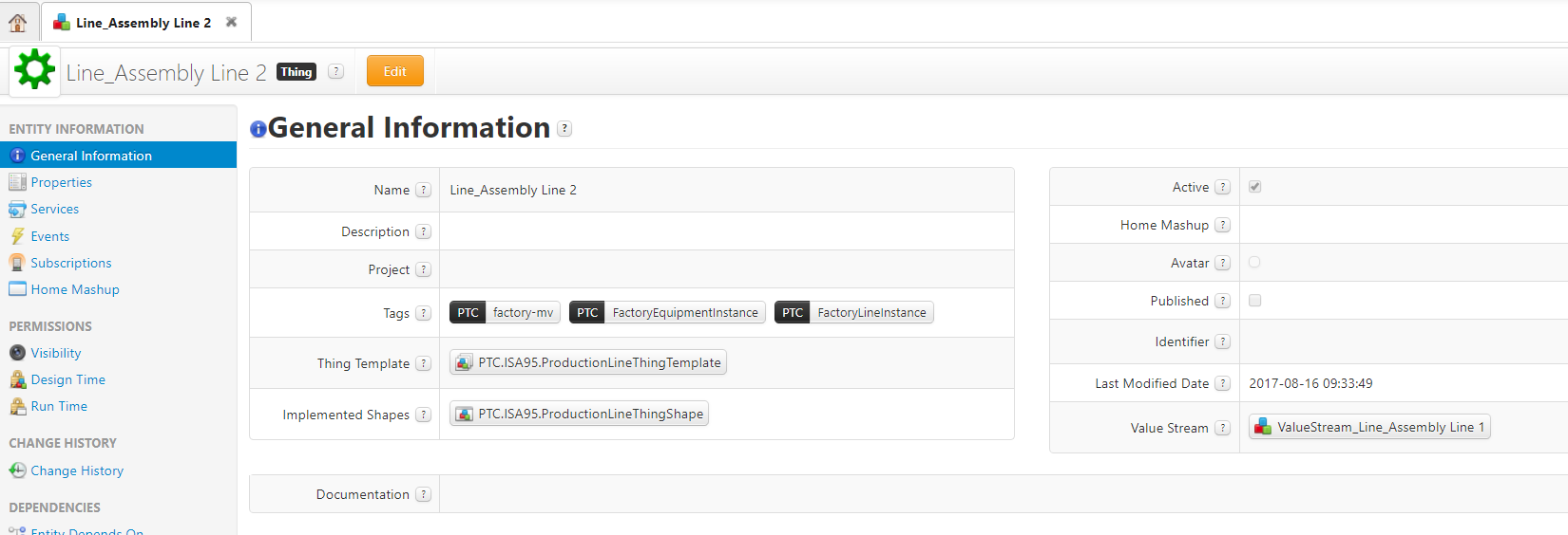

Since I have 10 line, I would need to reconfigure everything 10 times. Duplicating the line as you suggested does not work because it does NOT duplicate all of the assets on the line as well. Just tried it using composer and then checking the result on manufacturing apps. The line I duplicated displays with an error in the manage resources view of the config and admin tile.
Line I duplicated:
Line originally created using manufacturing apps:
View of the line properties in manufacturing apps after duplicating line 2:
