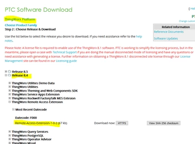

Hi @mnaeem.
You need to download and install the Remote Access extension for your release of the product:
Regards.

Thank you very much @slangley ,
After exporting all the required extensions closed the composer and restarted tomcat.
