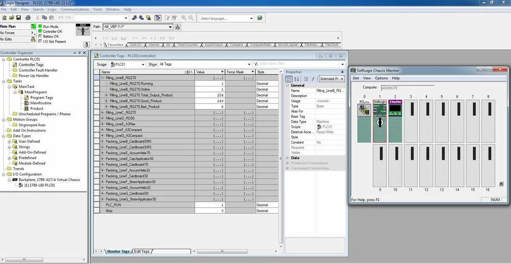

In VM.2,
I create a PLC program, download into SoftLogix and simulate some data.

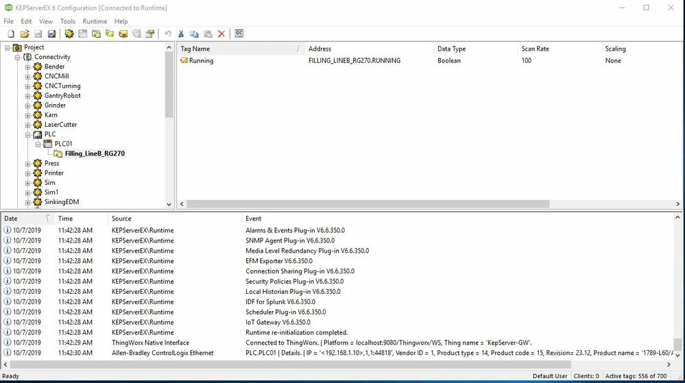

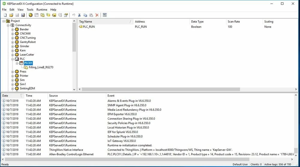

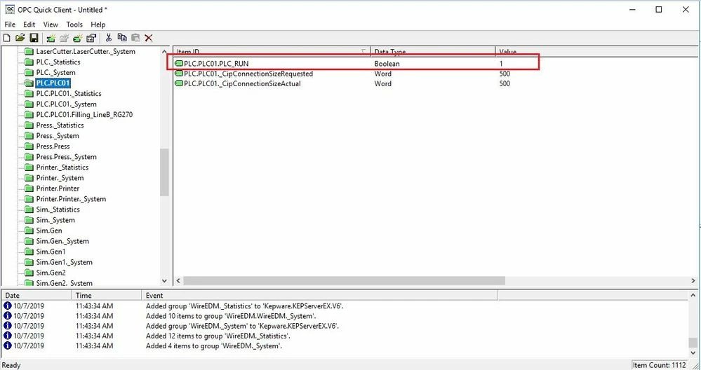

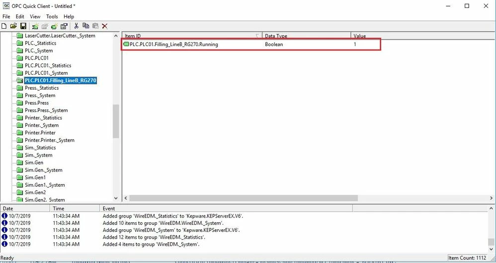

I configure the tag in KepserverEx and check the data in OPC Client already.

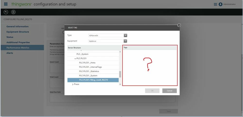

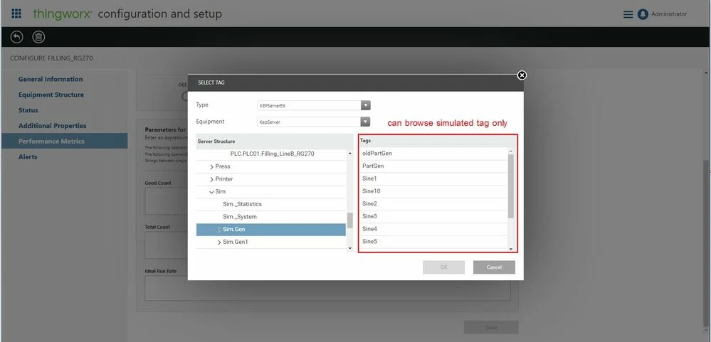

In ThingWorx Manufacturing Apps, I add new machine and try to configure the KPI.

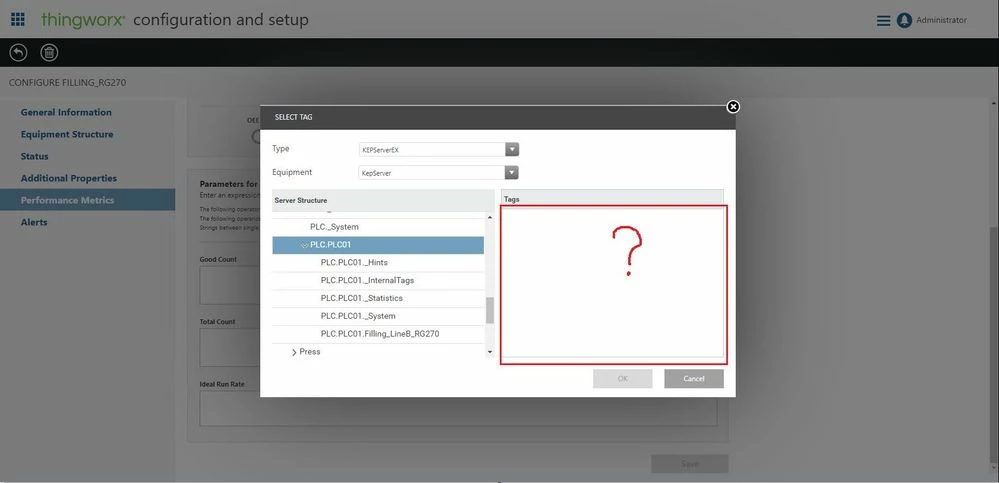

But in the configuration and setup, when I browse into PLC tag. I cannot see the tag I just add into KepserverEX.
I found just the simulate tag, not tag from SoftLogix.
RSLogix5000 and SoftLogix

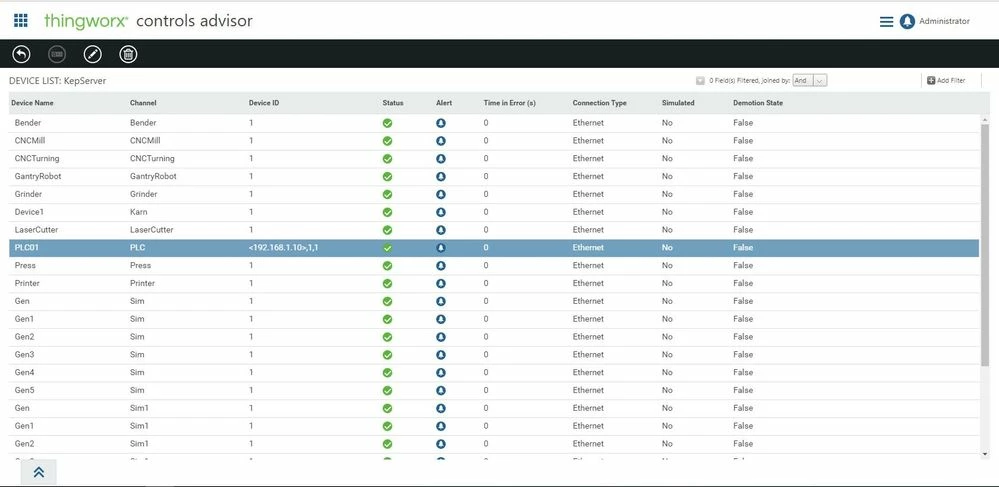

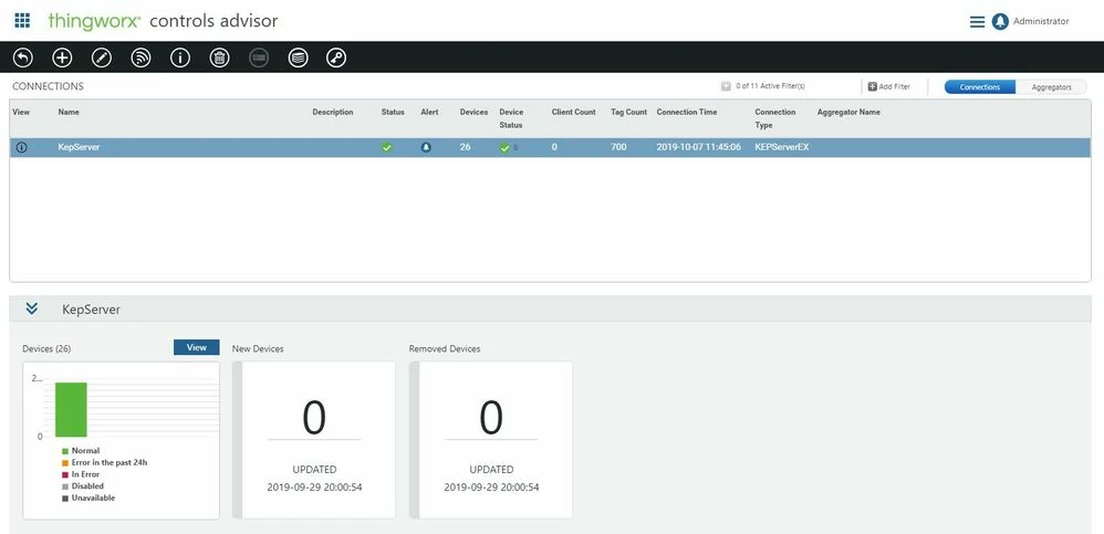

ThingWorx Manufacturing Apps : Controls advisor
Cannot find Tag in Kepserver that added from Softlogix
Find Just Simulated Tag in Kepserver.
I try to change from Kepserver to Industrial Connectivity, but the result is the same.
