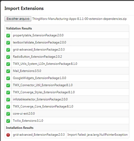

ThingWorx Manufacturing Apps extension dependences error "Import Failed: java.lang.NullPointer
ThingWorx Manufacturing Apps extension dependenced fails to import.
  • ThingWorx Platform 8.1.11
  • ThingWorx Manufacturing Apps 8.1.1 and 8.1.2 (I've tried with both)
  • Apache Tomcat 8.5.37
  • Oracle Java 8 upd92 and upd202  (I've tried with both)
  • PostgreSQL
  • Microsoft Windows Server 2008 R2 SP1

Hey @jessicalopo
do you get the same error if you try to import the ThingWorx-Manufacturing-Apps-8.1.1-00-extension-dependencies.zip at once?

January 30, 2019
Hi @SebB
Yes I have the same error.

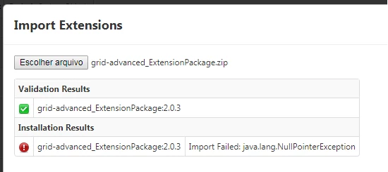

I've tried to import separated just to check if happens the same thing.
Thanks.

January 30, 2019
Hello Jessica,
can you please go to the composer -> Import/Export -> Manage extension and see if grid extension has already existed there? if yes, remove it and import the extension dependencies.zip file again. If not, kindly share the application logs.
