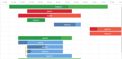

Hi, @slangley . I am using Manufacturing Apps 8.4. The widget is timeline chart.
I need something like a Gantt Char showing labels inside the bars, between two specific dates and times. Thank's
