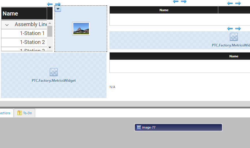

In MFG App, I have list of assets in grid. The grid is filled with data taken from GetPhysicalAssets service. When I select the row in the grid for the physical asset list, I would like to change the image widget placed in the mashup. How do I do that? Or is there any other way to achieve this effect?

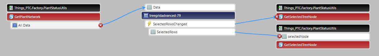

I'm trying to use MFG setup setup tree advanced grid and based on the selected row trigger a change in image widget.
Please advise. Thank you.
