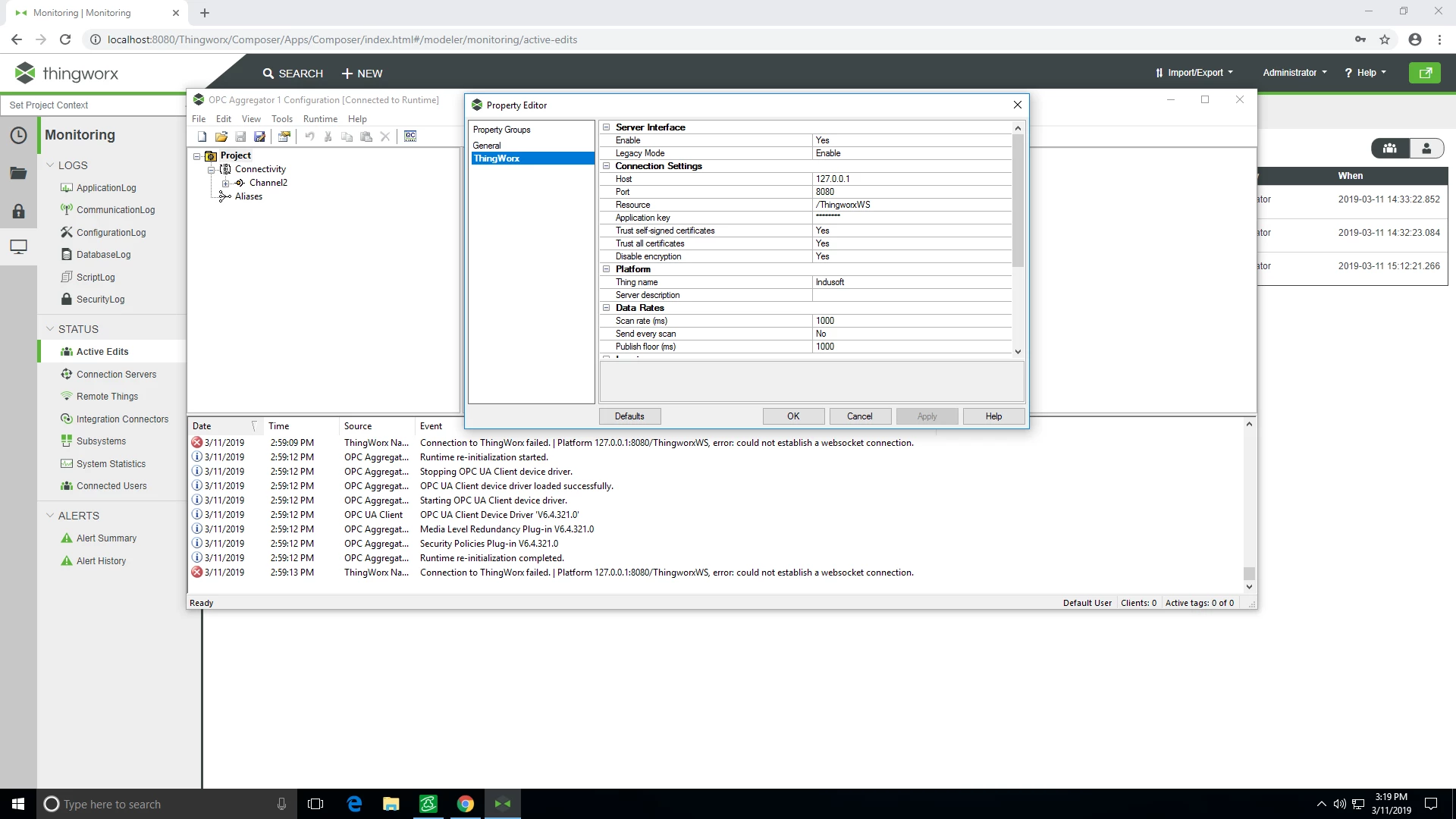

Hello, I am getting this error in OPC Aggregator configuration: ThingWorx Native Interface Connection to ThingWorx failed. | Platform 127.0.0.1:8080/ThingworxWS, error: could not establish a websocket connection.
I have created the thing name in thingworx with the correct template. I have also created an application key. Then I have followed the tutorial. It seems everything is correct, thing name, key ID, host and port. I have also tryied to enable legacy mode, change the host from name to IP and change the certificate settings.
There is a print of the configuration attached to the post.
Thanks for any help

Please change the Resource to "/Thingworx/WS" in your settings and validate.
You current value is "/ThingworxWS".

Thanks, it worked. When I changed the localhost to IP I didn't see this little mistake there.
