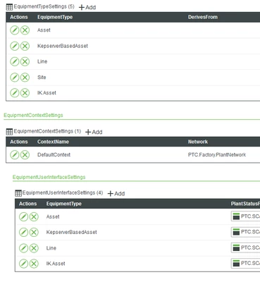

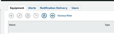

We can't create a new asset in Configuration and Setup. Add button is not enabled.
We have noticed that GetEquipmentTypesForDropDownMenu service (thing PTC.SCA.SCO.UIProvider) is returning an empty infotable, but there are 5 different equipments type in PTC.Factory.C_LaunchPointConfigurationThing_9.1.1_00.

The problem was the EquipmentRelationshipDefinition dataTable. We were using a dataTable that was empty.
We have imported data from our development environment and works.
