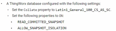

I am installing AMU in the Thingworx 9.3, and had encounter issue at step 11 of the Core 310 installation.
The error shown is as per below when i "Create Database"
Error in: PTC.SCA.SCO.DefaultProductionOrderManager.CreateEnumeration javascript service. Message ::An error has occurred. Contact your administrator for further details.
I am not sure what is should check further?
Do advise, i have checked the connection to the MSSQL database is connected.
And i hope to clarify, when i install the MSSQL db setup the Collation is
But in the installation guide, at Step 12, they ask for.
Should i create a new database?
Hope someone can help me on the step 11 !!

I hope to clarify further, when i install the MSSQL Thingworx foundation
it stated the following:
So i created a  database call thingworx, with the collation Latin1_General_100_CS_AS_SC.
The article show i required Collation SQL_Latin1_General_CP1_CI_AS.
Does that meant i need to create another database? as i cannot change the Collation in the exisitng database.
I followed the step in Install Guide CORE 3.1.0 Clean Install, and Chapter 11, "PTC.SCA.SCO.MnfgCommonDatabaseInstaller" services Create Database. I got the error.
I read in the Chapter 12 of Install Guide CORE 3.1.0, ""CoreStoredProcedureConcatenated.sql" will create and required Collation SQL_Latin1_General_CP1_CI_AS.
But i had issue at the "Core" and not able to proceed to Chapter12, as i encounter the problem above error.
I hope to check, i installed the AMU over an existing Manufacturing Apps with some setup, should i delete anything? is there any guides in regards.
Do advise.

Hi @newieKek.
I worked with R&D on this question a couple of years ago, so I can confirm that you need to use Latin1_General_100_CS_AS_SC.  I was advised that with varchar based data, there are small but significant differences with the sorting and comparison of data which may have an impact on upgrades and other unexpected consequences.
Here's an article that may help you to change the collation.  Here's another article that may also be helpful.   Be sure to create good backups before beginning the process.

I just wanted to let you know that the recommended collation for ThingWorx Platform and RTPPM are different, as you pointed out.  As you discovered, RTPPM does require a separate database.

I re-installed everything, and discover, a sentence in Page 19/35 of Core310 installation manual.
* It mentioned: <DATABASE_NAME>: name of the database where you install the ThingWorx Manufacturing Apps. ( ThingWorx Manufacturing Apps and ThingWorx Apps are to coexist on the same database)
When I install the ThingWorx with Mssql, i used the thingWorxMssqlDBSetup.bat, when i install the Manufacturing Apps, i connect my Manufacturing apps to the database created by the bat file.
So in order to fulfilled the installation of the AMU/RTPPM, i need to create a New database with Latin1_General_100_CS_AS_SC. So i had successfully install the AMU and RTPPM, now struggling with the configuration of the app.
