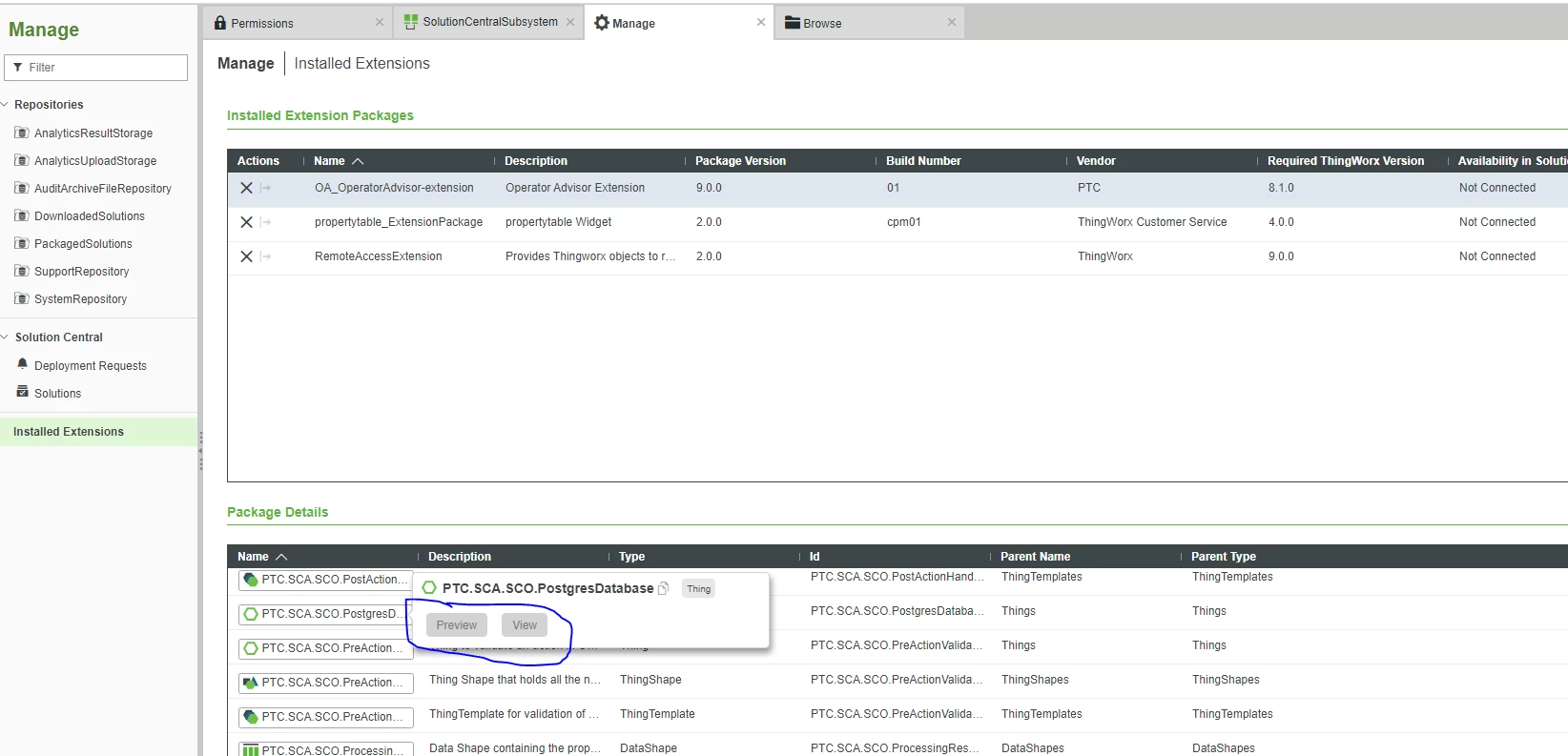

I am trying to install Thingworx Mfg Apps extension on my thingworx foundation 9 instance.
I am able to import the extensions sucessfully.
However in the Manage-->Installed extensions page , i am unable to edit the database thing PTC.SCA.SCO.PostgresDatabase. The preview and view buttons seems to be disabled.
Infact, i could'nt edit anything that was imported, so i am not sure how to edit these from here.
I followed the help center installation instructions, but am i missing some step?
Attached is the screenshot of the problem.
Kindly help me out

Hi @vigneshmurthy.
It looks like you're in the wrong place.
I'm not sure which version of the product you're running, but you need to follow the "Post Import Database Configurations" from the comparable page for your version in the Help Center.  Here's the link for the 9.0 version.
Regards.
--Sharon
Support
Hi @vigneshmurthy.
