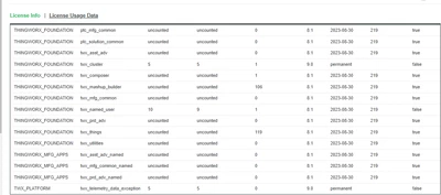

Hello Everyone,
I'm using twx composer version 9.3, and I've imported twx Manufacturing common as for twx manufacturing app, I've even exported the thingworx asset monitoring and thingworx utilities, in my local server. Now the problem is I'm not able to see control advisor.
Please let me if I've exported the correct manufacturing extensions or not, if yes, then why can't i able to see it in my composer.
Thanks in advance!
AS

Hi @AS_1307.
This could be a licensing issue.
In Composer, navigate to Monitoring > Subsystems > LicensingSubsystemSettings, and provide a screenshot of all the features you see there.  Be sure to capture all columns and rows in the screenshot.

Hi Sharon,
PFA,
AS

Hi @AS_1307.
Your license looks fine.
After re-reading your original post, it sounds like you may not have installed all the needed components.  When you installed Mfg Apps, what procedure did you use?  You need to follow these instructions.
