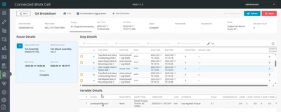

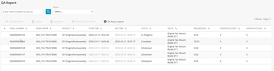

In CWC-Extended, there is a new report called QA Report. It allows you to see the list of serials :
You can select one and see the steps. And if you select a step, it gives further details in the bottom section including the values entered during execution.
